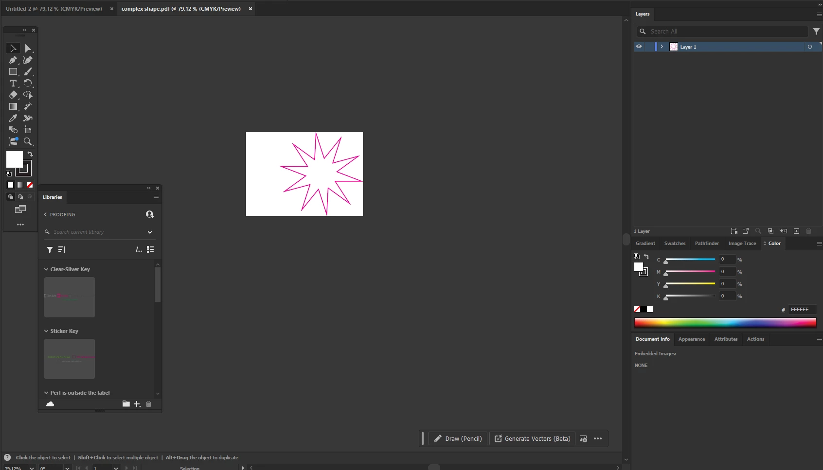

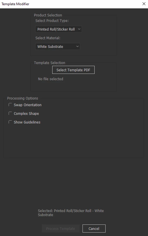

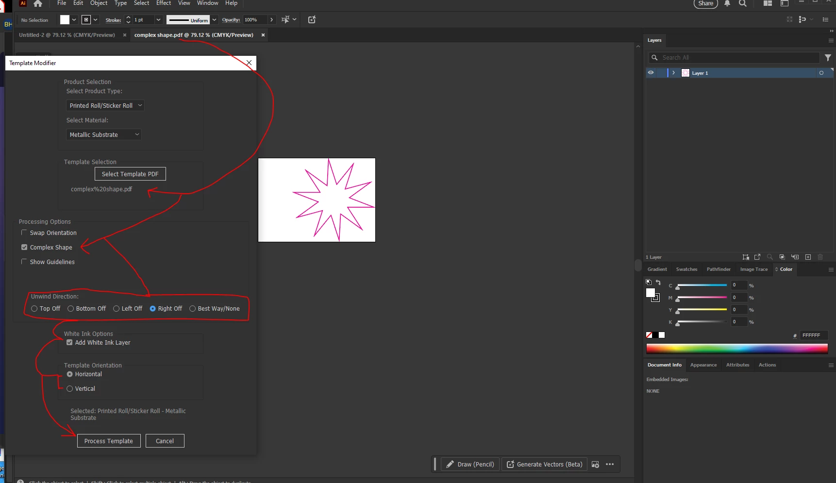

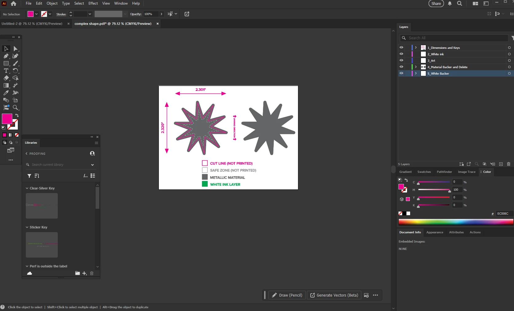

My UI basically modifys a die line to make a Proof layout. I'll put some examples below. of some of the outputs and how the UI moves. Not sure exactly what would be useful to share. Still going to keep testing in the mean time and will post my solution then.
The base UI:
 Example of a submitted file:
Complex output:
After proess template is completed:
