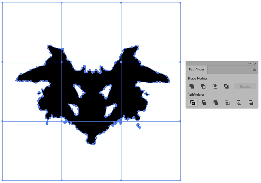

Object>Path>Divide is not working for paths made on a grid
I made a shape with the pen tool and then put a grid over it. I wanted to use the paths on the grid to divide the shape but it is not working. I make sure the path was above the shape, I tried just cutting with the scissors, and even making another shape with the pen tool but nothing works.

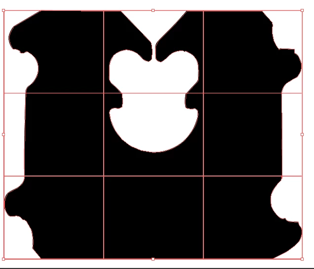

    That’s because your grid does not close.
    the lines should overlap or at least connect.
    it will work if you do it like this

    What Ton said: Divide tool
    With the grid on top. Select everything, Window > Pathfinder and click on the Divide tool (bottom-left) in the Pathfinder window.
    Then R-click > Ungroup.
    Jul 13, 2026 1:19 AM UTC
    It only does a portion of it when I divide and ungroup it. I have tired arrangind the grid on top piece by piece to get it to cut but it still only does the divide in parts with the pathfinder tool.

    ​@New to This Did you try the Pathfinder panel Divide option?
    Jul 13, 2026 1:20 AM UTC
    Yes, I have but it only cuts it in parts, 6 of the pieces will divide but the bottom third will not cut as three pieces, but one. even after I ungroup them.
