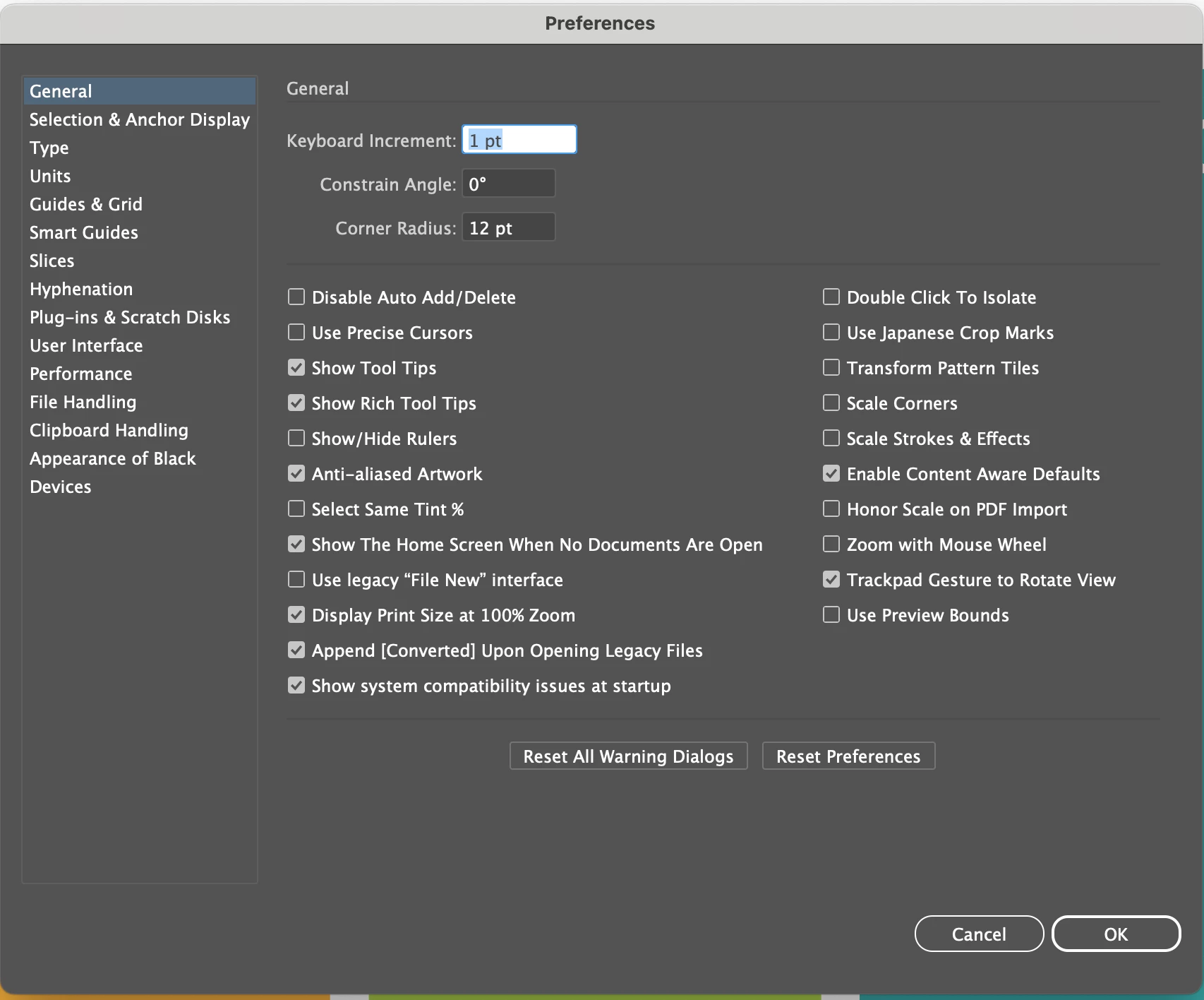

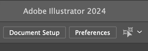

Apr 3, 2024 1:16 PM UTC
Just adding a new comment here even though it's two years later. 🙂 I'm on a Mac for reference.
1. Click on your artboard in Illustrator.
2. Chose the "Preferences" button next to "Document Setup".
3. In the "General" tab, unclick "Double click To Isolate".
4. Restart Illustrator and hopefully that solves your issue.
