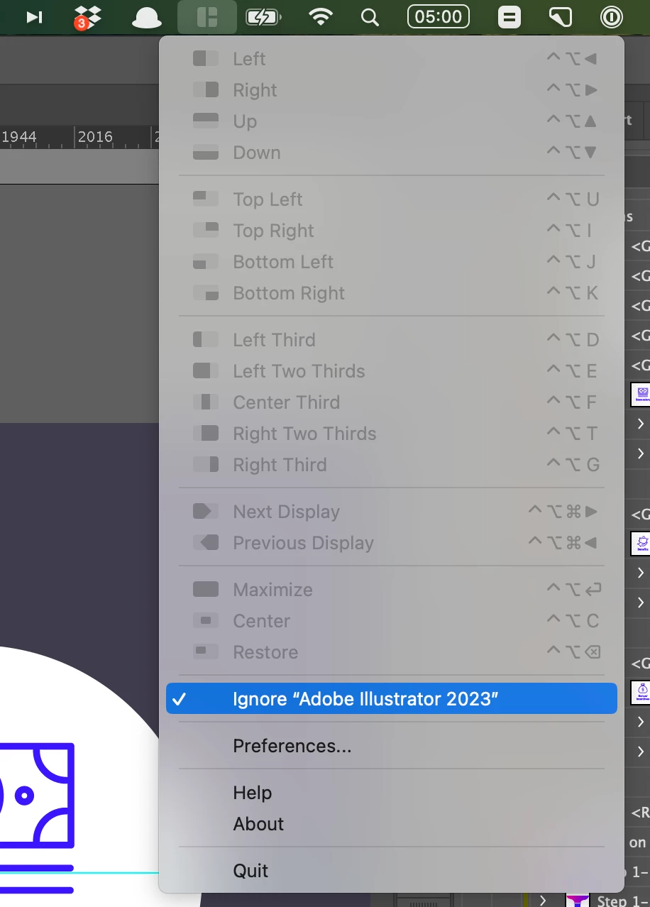

just posting the solution that worked for me.
i'm on a mac and have the app 'magnet' running. if you tell magnet to ignore illustrator the issue is fixed. click on icon in toolbar and check 'Ignore "Adobe Illustrator". (illustrator must be running in foreground to see this option)
