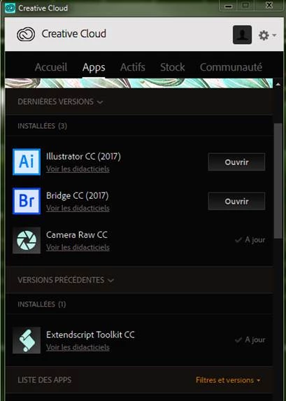

  1. Question: Do you need UAC right for windows in order to reinstall using Creative Cloud window?
EDIT: apparently Ai do requires Admin right to be reinstalled
     ESTK doesn't
