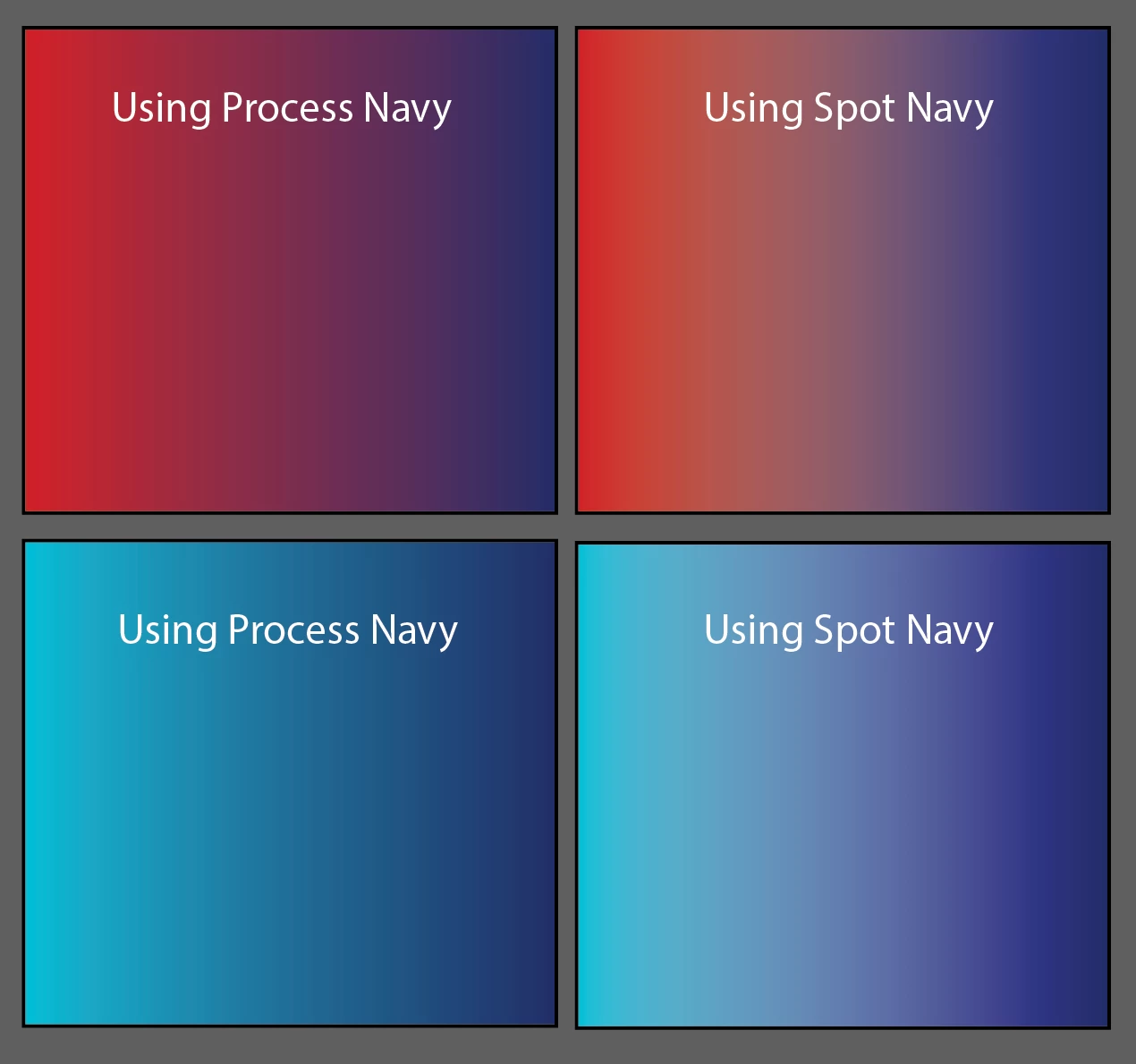

I am printing a business card and one of my gradients is being printed the wrong color. It's a two color gradient, from light blue to dark blue, but only the dark blue is coming out gray. This is weird because that same dark blue is covering the entire back of the business card and on other parts on the front where the gradient is, but those come out dark blue. It's just the gradient portion of dark blue. I am using a mask to create a shape out of the gradient as well, if that means anything.

    You're also up in what we like to call the "Blurple" range. A blurple is a blue that prints more purple than it looks onscreen. For CMYK you will want your Magenta and Cyan channels to have a minimum of 20% difference in their values. Navy Blue, Royal Blue, Cerulean Blue, etc - all cold blues can muddy up this particular gradient because you're pushing a warm into a cold.
    Also, google "Navy Blue CMYK" and drop the K and Y channels as low as possible to keep color polution to a minimum.
    September 20, 2019
    You can select the objects containing the gradient and Object - Flatten Transparencies. Unfortunately, that will replace the spot color info with CMYK. Old school, we'd do a hard copy with Printer Notes to identify spot colors in design elements.
    September 19, 2019
    Looks like you've already figured out how to remake the Navy blue as a process color so it is compatible with the process light blue in the gradient. If you need to re-adjust the gradient transition to compensate for any visual changes you can select the object filled with the gradient, select the gradient tool from the toolbar & drag across the object to define the transition or you can select the gradient swatch in the swatch menu and open the gradient window to edit the transition in the gradient itself. Sorry if you already know all that.

    Yes on a color printer. And changing the light navy to a process color fixes this problem for printing, but it also changes the transition of the gradient. Is there any way to preserve this?

    Changing the spot to process will also change the transition. You may need to adjust the colors to your liking.

    I see that one of the colors is a spot (the Light Navy) an the other one in the gradient is a processc color mix.
    Are you planning to use the spot color for printing?
    The blend between the Process and the Spot probably causes the problem.

    I'm actually working on someone else's project and going from there. How do I change the light navy to a process color? And how would I be able to see this information to check colors next time?

    When you double click on a swatch, you can change the type of color it is there - a dialogue box pops up and one of the fields is between process and spot color.
