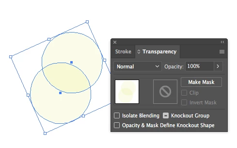

Opacity settings won't go back to 100%
In CS6 I have shapes I've made transparent in the past and maybe applied Multiply Mode. But in the Transparency window it shows/says it's Normal Mode/100% - which clearly isn't the case, so there's no way to change it. How do I return it to Normal/100% - which currently I cannot? Nothing I try works & at the moment, the only solution is to recreate these shapes anew! Might anyone have an idea on how to "unfreeze" this past opacity change so I can see it's true values - & - change it? Many thanks!

    i think when you make transparent objects, and group them, the transparent will be 100% for the group. you have to ungroup first.

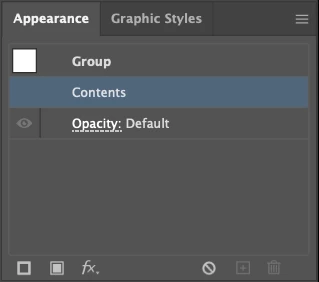

    In my case Solution was:
    Select object > Go to Appearance tab > Double click on the line that says "Contents" (see attached pic).
    Within that the object had three or four  "Opacity" instances applied to it, one of which was set to 50%, I selected it and deleted it.
    I think the issue occured due to importing .svgs to AI from Matlab.
    Good luck!

    the problem that she is grouped the transparent objects, when you select the the group, the opacity will be 100% (for the group). but objects inside the group have opacities.
    when ungroup the object you can change the opacity to 100% for each object.
    also you can change it from appearance panel for sure.
    but ungroup the objects and change each one, or use group selection tool to select the transparent object within the group.
    * grouped transparent objects, the opacity 100% for the group in general not for the items inside the group as individual.

    No. That's not the problem.
    You can use the transparency on layers or groups or page items or any path items. See what the appearance panel shows you while selecting the layer(s) or group(s) or page item(s) or path item(s).
    That's why it would be better to see a screenshot. But without - it's only a shot into dark.

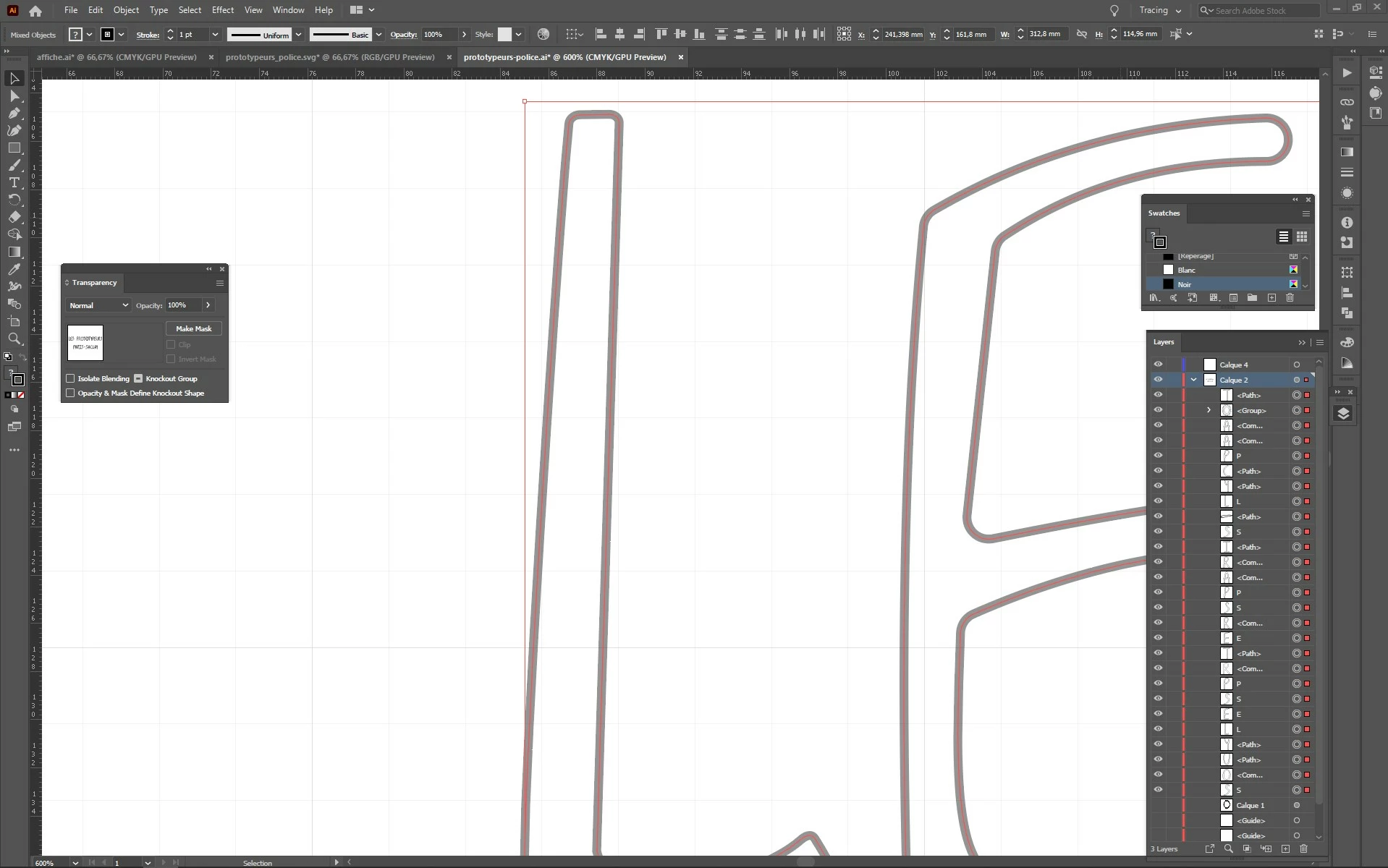

    June 11, 2021
    Hi everyone,
    I have a similar issue. My strike should be black not grey. I have changed the color to check and I'm pretty sure it's a problem of opacity.  Here is a screen capture.  Do you see what's wrong ?
    Johanna.
    June 11, 2021
    I just moved all the folders from "calque 2" to an other new layer and my strike are black now, yes ! But I still don't know why "calque 2" hasn't a full opacity.
