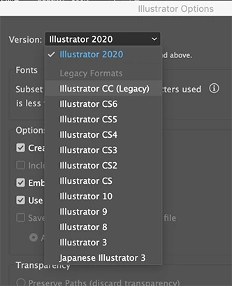

I am noticing that working files started with Illustrator 2020 are becoming corrupted when opened in Illustrator 2019.  Layer information is being collapsed into clip groups.  Is there a setting that can stop this from happening?
Correct answer Ton Frederiks

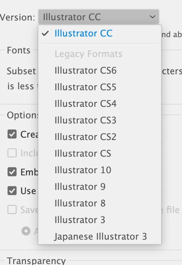

Is there at least a way to enable saving to legacy formats for compatibilty?
Yes there is in 2020: legacy CC
November 18, 2020
Just save others a little of their precious time if they're confused as to where the dialogue box to save legacy files actually is, after they've clicked "save as" - it appears AFTER choosing the location in the Save Dialog of OS X, and apprently not at all when saving to creative cloud.
