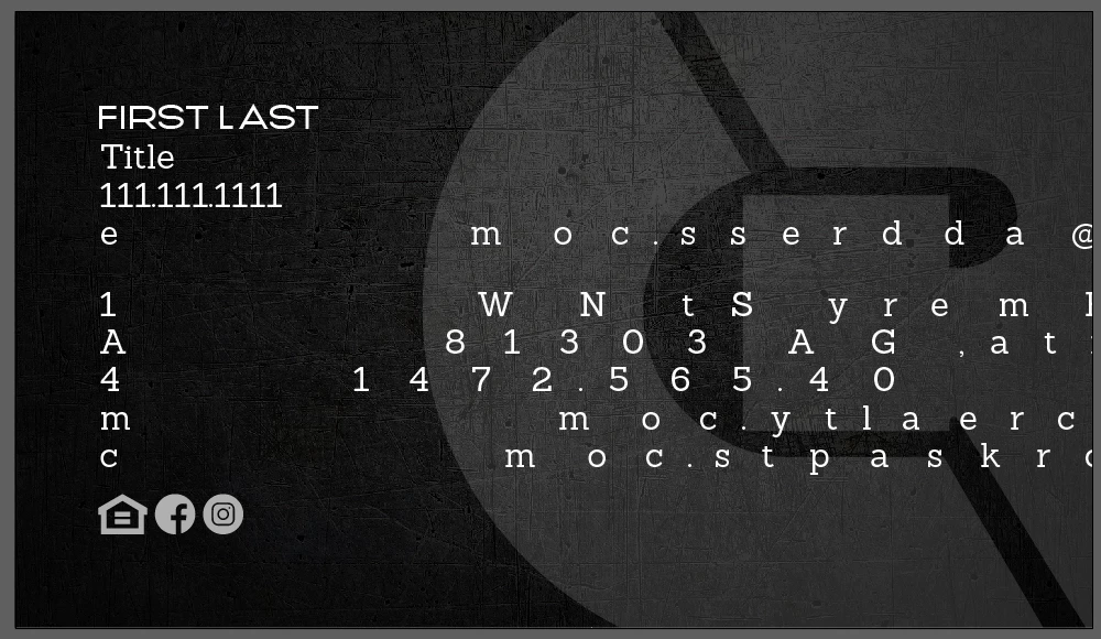

Hi there, our print company has encountered this problem numerous times when working with PDFs for print-ready artwork, our online proof generating site, and opening those PDFs in illustrator to make art changes or adjustments to the text. I've finally decided to try and reach out for help on solving this issue that we sometimes run into. I understand that Illustrator is first and foremost not meant to open and work with PDFs but I am hoping there might be a solution or a workaround that someone is aware of.
I believe the only PDFs that do this to us are the ones generated from our website using a web-to-print template software, even if the PDF was originally output from Illustrator or InDesign at the beginning of the process. This probably means that the originating issue is the site, which doesn't bode well for our circumstance. The issue we run into is when opening these PDFs in Illustrator, everything comes in fine including the font file with the exception that text is extremely stretched out, and reversed. The font is installed locally on the computer that opens the file, as well as is part of our font sharing plugin library. I can see that each character on the line has its own unique kerning value applied (1244, 1502, 1114, etc.)
Additionally, the words on each line have been reversed: in the attached screenshot, the first line that is distorted is meant to say "email@address.com" but "moc.sserdda@liam" is what is displaying in Illustrator, with the initial E starting the line staying correctly where it should be.
I don't know if anyone else has ever encountered this and I don't know if there's a solution. We're just hoping to have some kind of answer because "Illustrator isn't meant to open PDFs" will not fix that our website's current web-to-print software can only output PDFs and we sometimes need to make adjustments to the artwork after it's been generated. (Of note: sometimes Acrobat Pro DC messes up the font in a different way, so we can't always make our adjustments just by opening the PDF in Acrobat.)

When you ultimately get the PDF, are you then pushing it through to the RIP ( when you do, do you see the problems )?  Also, when customers go to your web portal, they download the template and proceed to add their Illustrator or InDesign content?  Do you give customers a live .ai file to work on?  Not sure what file type your template is.  But, it could be the font and typography info is not being saved when they create the final PDF.  So text would, hypothetically, be interpreted.

Are you getting any error messages when you open the PDFs?
If this issue is only with PDFs from your online proof generating site, it sounds like the issue is being created by your site. Can you possibly attached one of your proofs, so we have something to look at as well as the original PDF for tht layout that you received from the client?
June 3, 2020
No errors or messages when opening the PDF, no. I've updated my original post to include the original customer PDF that came out of indesign (opening it is just fine in Illustrator) as well as a PDF output from the site where the font gets kerned backwards.
