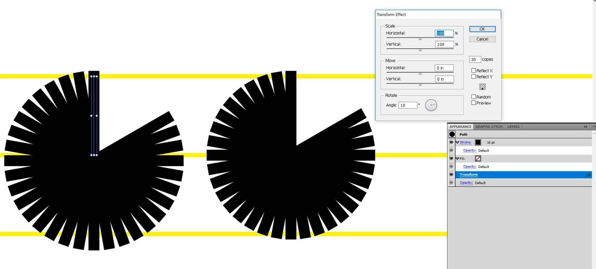

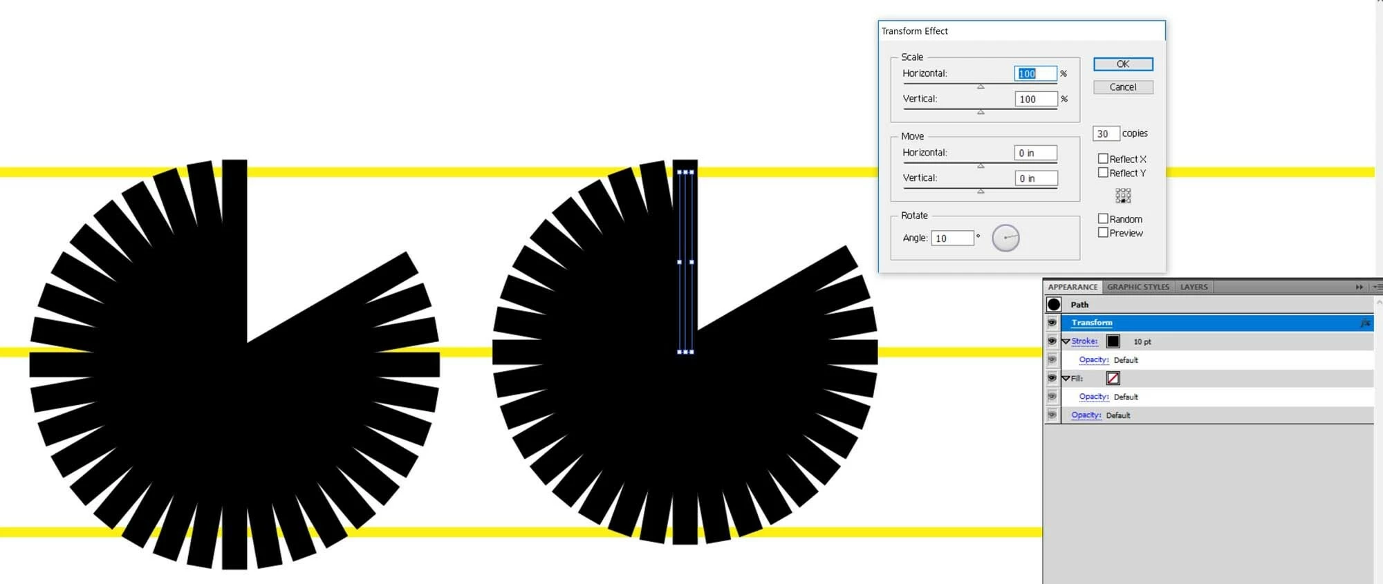

    sPretzelAuthor
    Apr 26, 2026 1:09 PM UTC
    Hi Monika,
    Thanks for taking the time to answer. I have attached two screenshots: 1- showing Appearance of left line, 2- showing Appearance of right line. Only the position of the Transform FX in the stack changes. I expect the two transformed lines to be identical and look like the one on the right.
    While I was preparing the files, I noticed that it is the stroke cap that is the culprit. Here, it is set to Projecting Cap (same if Round Cap) but if I set it to Butt Cap, the issue is gone and the left and right lines look the same, when transformed. Still, I don’t understand why AI behaves this way since the bounding box of the lines are the same, regardless of stroke cap. And the bounding box does not account for the butt cap.
