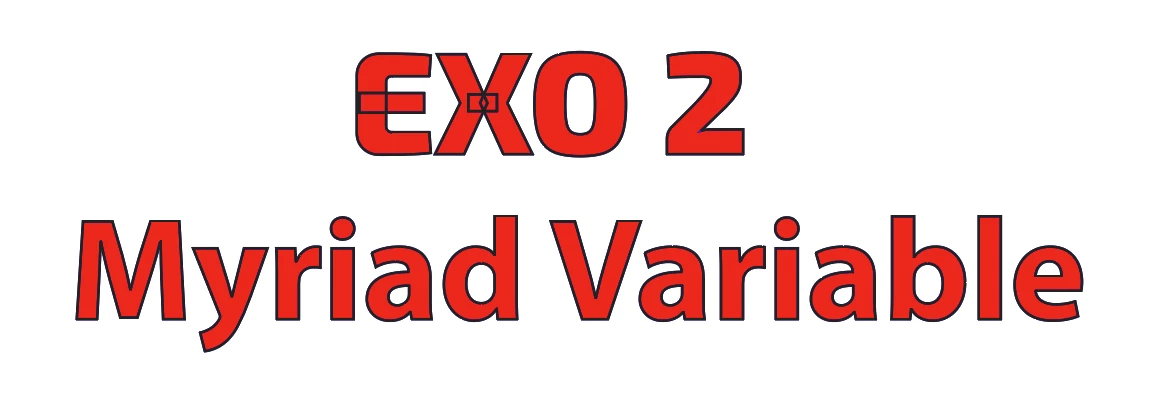

OUTLINE/STROKE Issue inside font/letters
Hello Community,
I have a very strange problem which appeared out of a sudden last week.

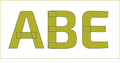

As you can see on the attached image:
When I use a certain font and put an outline - then the outline shows every single bar of the letter.
It is a google font "EXO 2.0" which we use as the main font for our company for years now. We never had a problem with this font.

I just checked and yes it appears on all VAR Fonts.
This is weird - since it does not appear on my other computer though - using the same font.
The family only added a variable version last year -- are you sure it's the same font on both machines?

"In March 2020, the family has been updated to a variable font family."
This occurs with all variable fonts in Illustrator, since they are constructed from discrete shapes that get wider/narrower.

I should say it happens with some variable fonts -- I'm not sure why some and not others:
Some discussion of workarounds here:
https://community.adobe.com/t5/illustrator/removing-overlaps-in-lettering-from-variable-fonts/td-p/11645636
For instance, add Outline Stroke and Effects > Pathfinder > Add to the stroke in the appearance panel:
