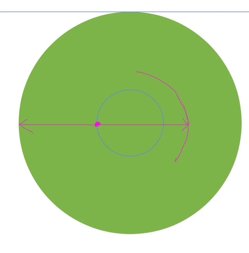

As suggested, you will have to change stroke to an offset, or manually deleting the extra "holes"
What is happening is your stroke is bigger than the object it's applied to, and strokes are centered on the path, so while half the stroke is going outward, the other half is going inward. In the case of the "dot" it's going past the edge of the dot in the opposite direction, and this path is being drawn in the opposite direction (due to a thing called winding direction) so it's essentially cutting a hole. There's no "fix" for it per se. That being said, this phenonemon mostly affects curves, especially those in a compound path like a font letterform, but its not limited to that.

Really appreciate this explaination. Super helpful thank you!
