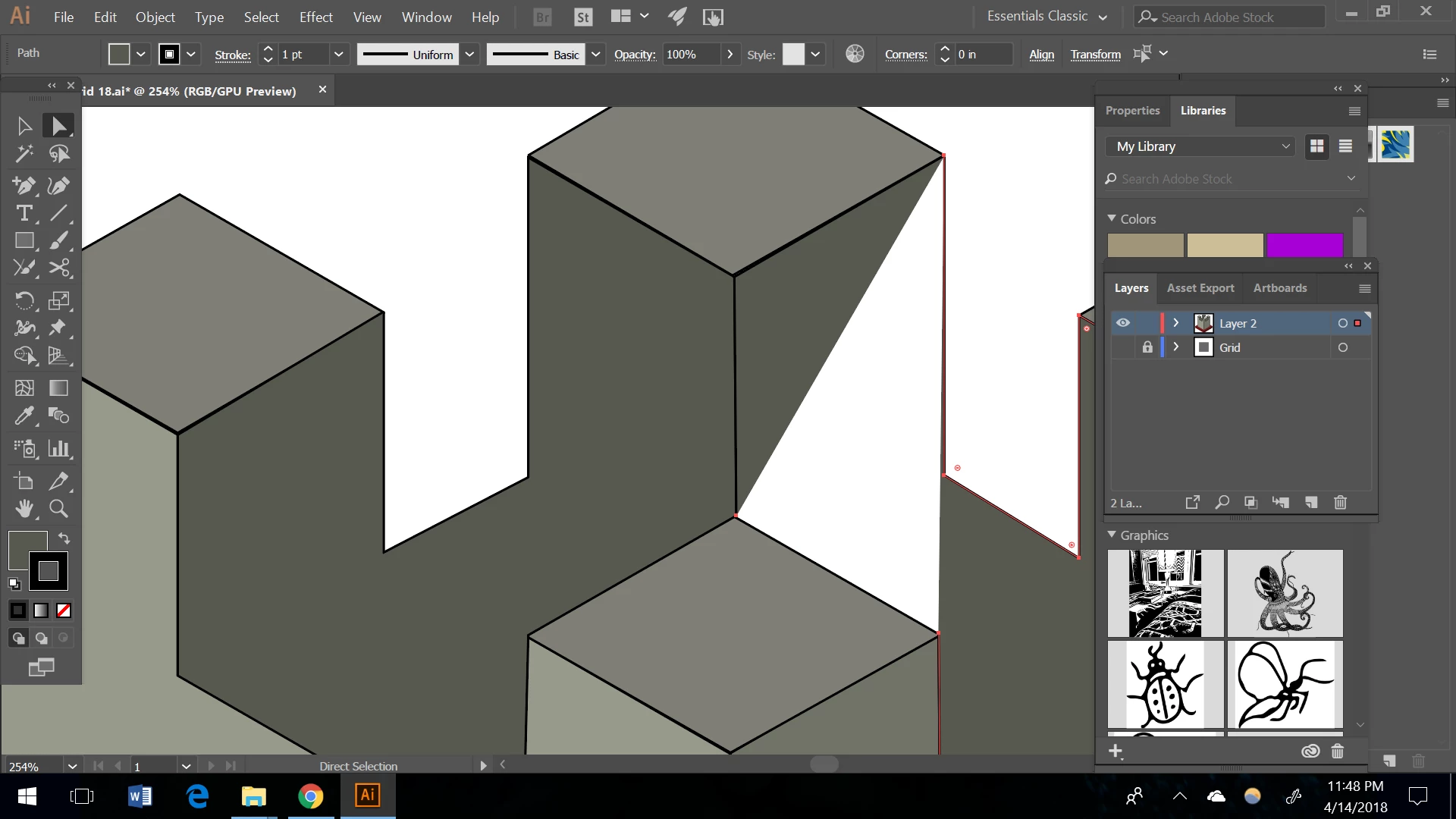

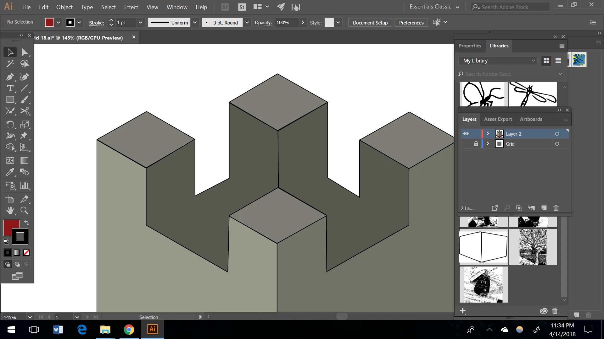

Hello Adobe forums! I've been searching and troubleshooting an issue I'm having when constructing larger shapes with series of smaller shapes. The adjacent shapes have very uneven stroke thicknesses because the strokes are somewhat overlapping (first image). I've already seen some similar questions, and attempted to follow the advice of using direct select to delete the overlapping path segments and using the scissors tool to do the same, but when I do this I lose a large piece of color (second image). I know I could fix it in Photoshop easily, but I'd rather get it right as a vector.
I DID just recently learn to trim overlapping corners with the scissors tool, and did that everywhere I saw them. Is it possible I deleted too much with scissors so deleting the paths now results in the changed shape? Did I just do a lousy job aligning? I appreciate any advice from anybody with more experience. Thank you!
