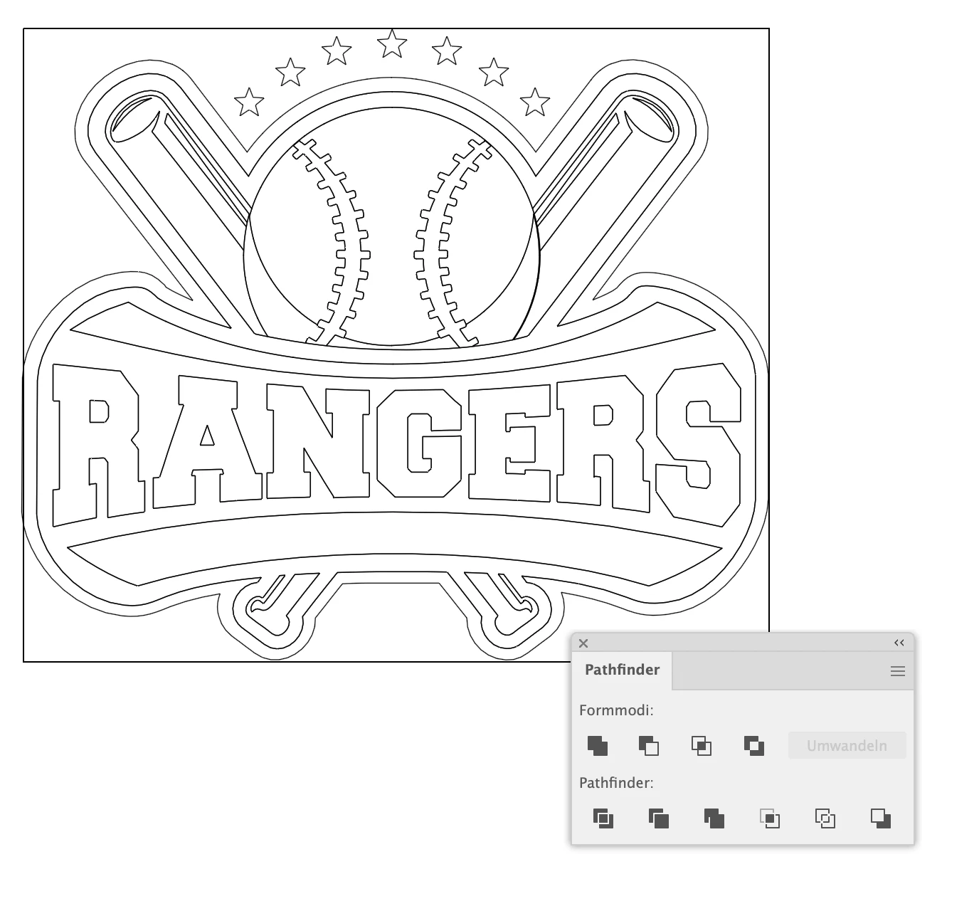

I didn't keep it. All I did was select all the objects and then hit the button "Merge" (bottom row, third from the left)

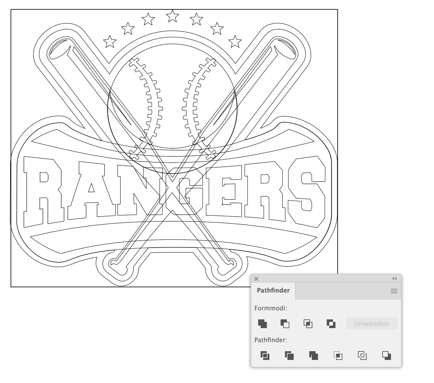

You could try if selecting all and then using the Pathfinder Merge does it as you want.
This is what I get:
Before:
