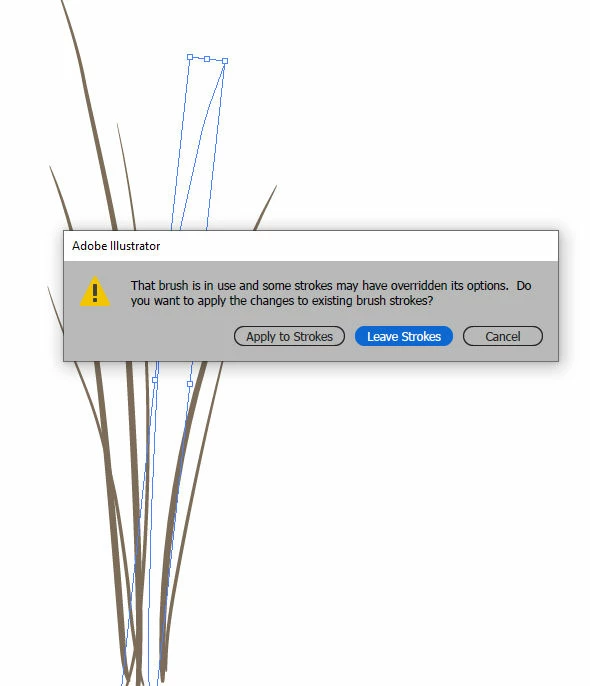

I am doing a tutorial that requires me to make a couple of brushes.  Problem is there is no instruction on actually using the brush and getting the settings right.  This brush should be applied to strokes and scattered along the strokes.  I can't figure out how to set it for this.  Here is a screenshoto of the setting pane.  Hope you can help since the author left that out.

... and once you open the scatter brush settings, set everything to random and then set up Min and Max values.

I see where I missed that choice in the tut now.  I have everything set to random but have clue how to set the other values.  I will look for an Illustrator help page for that.  Thank you!

Still having trouble with the scatter brush.  I am double clicking on the brush and nothing happens or I get this
error message.  Are my paint strokes suppose to look like that when I double click?

The brush is defined as an Artbrush. It sounds like you actually want a Scatter brush.
Add the brush to the Brushes panel again, and this time choose Scatter.
