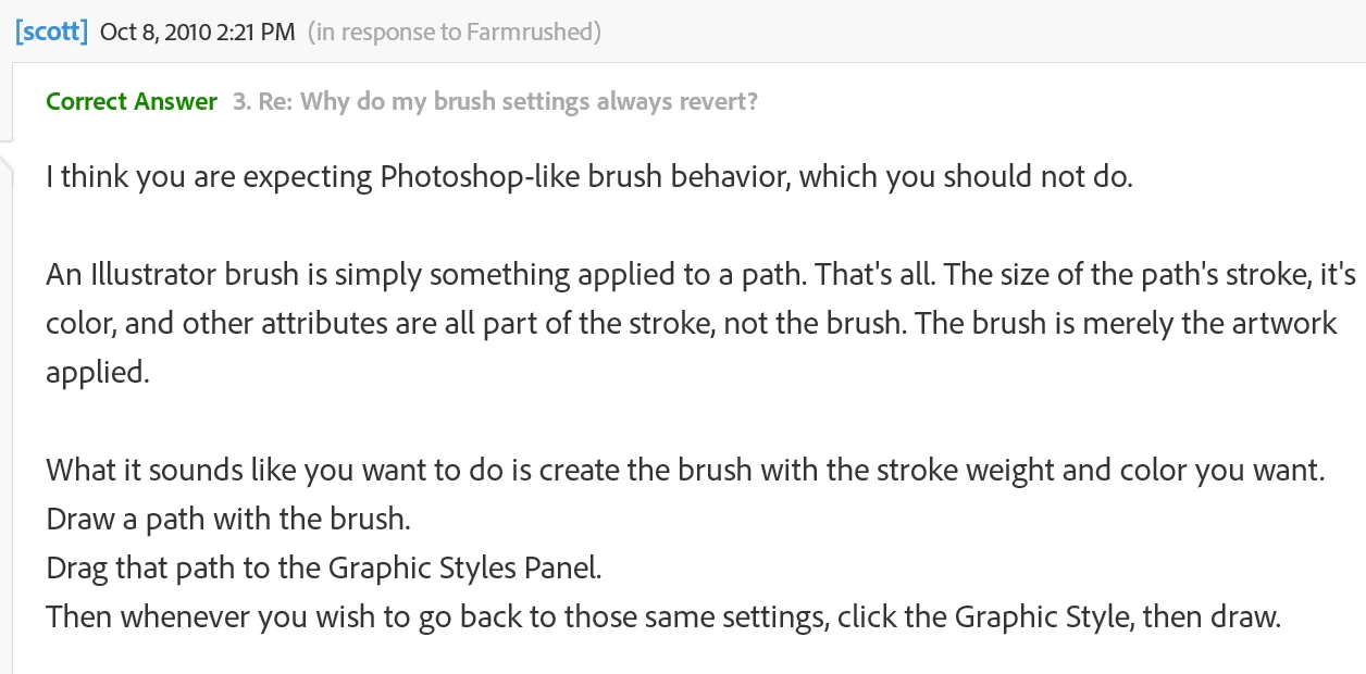

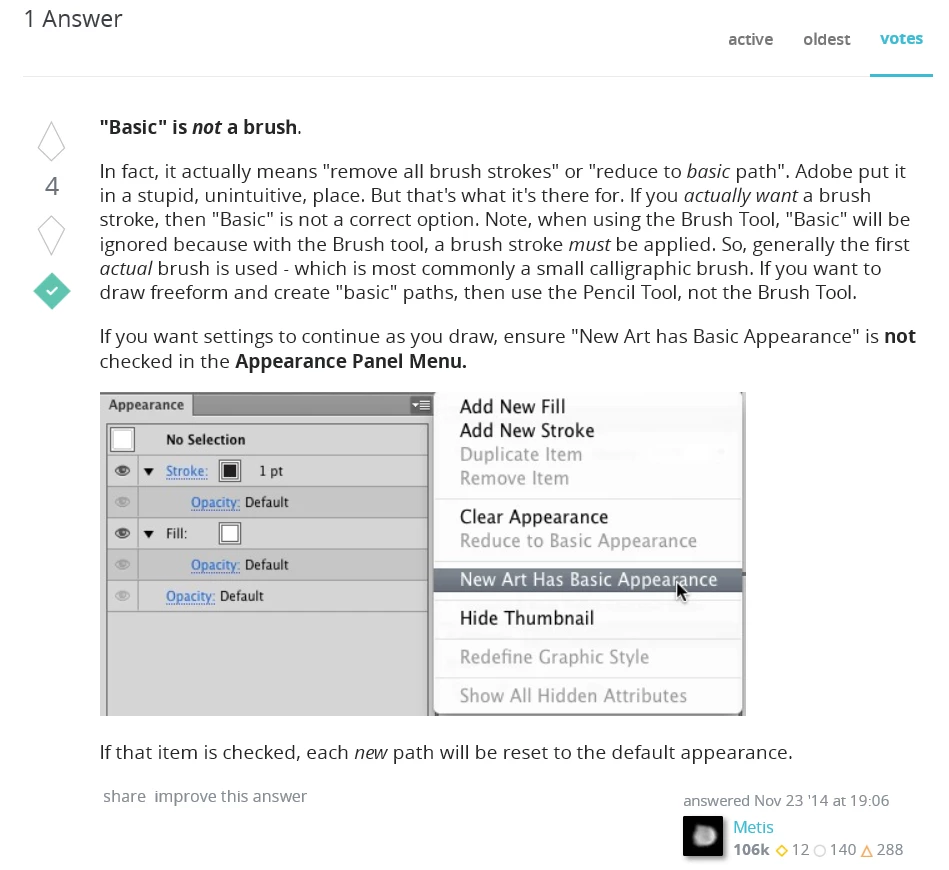

    On the few occasions I've use the paintbrush tool I've noticed a similar thing
    I googled the behavior before, I think it's just how the tool works.
    It will ignore Basic and use the next setting, in your case calligraphy 1pt.
    In the 2nd link Scott recommends  pre-making making a Graphic Style with the setting you need.

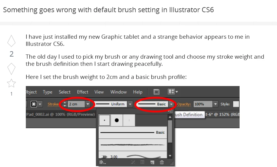

    Like these problem here?
    drawing - Something goes wrong with default brush setting in Illustrator CS6 - Graphic Design Stack Exchange
    or this link
    Why do my brush settings always revert?

    If you want to draw freely and don't need a brush, don't use the brush tool. The brush tool will always apply a brush.
    Use the pencil tool instead.
