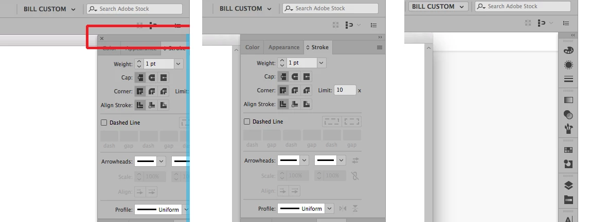

    Bill Silbert
    oct. 13, 2017 1:23 PM UTC
    You should be able to dock a panel or group of panels to one of the sides by dragging the group by the top bar (highlighted in screen shot below until you see a blue line appear. After that you will only be able to move any of the panels by dragging on its name tab in expanded mode or by clicking and dragging on its icon in the icon mode. You will also be able to move the entire set using the same top bar as you used to move the panels over in the first place. If you drag any other place within the panels they will remain docked.
    Traduire
    whyswonAuteur
    oct. 14, 2017 12:04 AM UTC
    I've tried doing this, dragging the panel to the edge and looking for a blue line with no success. It's still a floating panel.
    Traduire
    Bill Silbert
    oct. 14, 2017 12:29 AM UTC
    I would suggest trying one of the provided workspaces such as the one called "Essentials" to see if the panels within that workspace are docked. Remember docked panels can be moved in the manner that I mentioned in my first post but they will remain in place if you try to drag them from within each panel. If even the panels from one of the workspaces are not docking then you may have to trash your preferences to fix the problem.
    To do so:
    For Macintosh Users: With Illustrator closed launch a Finder Window in column view and click on your home folder. With the Option Key pressed choose Library from the Finder Go Menu. Within the Library folder find the folder called Preferences and within it find the following two files and delete them: “Adobe Illustrator <Version #> Settings” (earlier versions of Illustrator might just say “Adobe Illustrator”) and “com.adobe.Illustrator.plist”. When Illustrator is next launched it will create new preference files and the program will be restored to its defaults.
    After you’ve reset up the program (make sure that no document window is open) to your liking, it is a really good idea to create copies of your personalized “mint” preference files (make sure that you quit the program before copying them—that finalizes your customization) and use them in the future to replace any corrupt versions you may need to delete.
    For Windows Users: Hold down Ctrl + Alt + Shift when launching Illustrator and respond affirmatively when asked if you want to reset.
