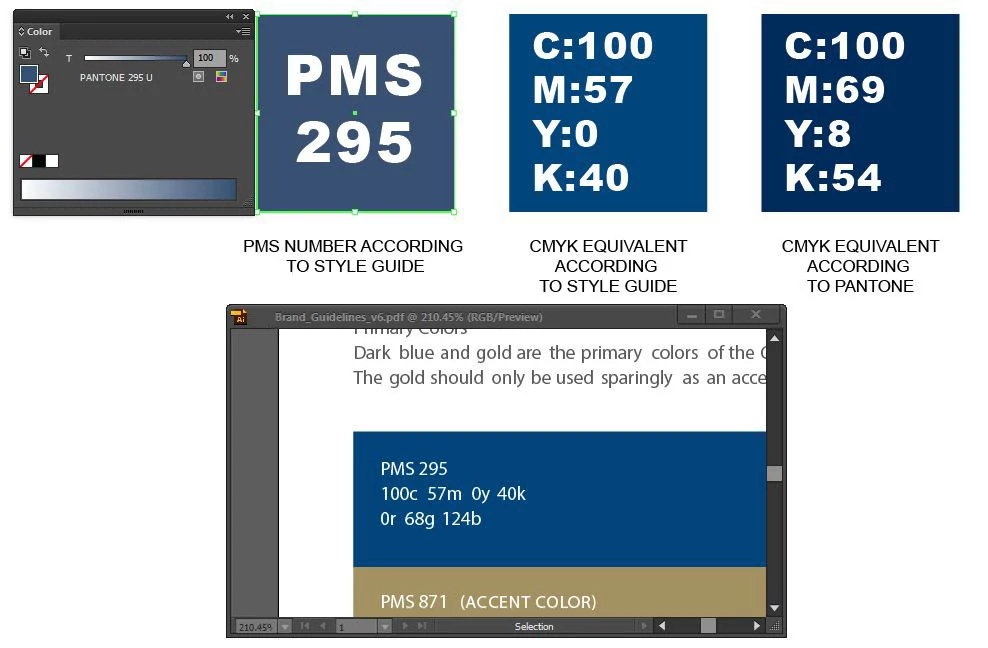

    Thanks for all the feedback. I spent a lot of the day yesterday trying to track down this issue and it was good to get some feedback from people. Below is a screen grab of what I am looking at. Clearly it will be slightly off from monitor to monitor, but as you can see this is a pretty radical shift in color. One thing I noticed is that the CMYK valused that the style guide is called out are different from the CYMK values that pantone called out in the Pantone plus color bridge. Thats what I am showing with the three blocks of color below. PMS color on the left, CMYK according to style guide in the center and CMYK according to my PMS bridge guide on the right.

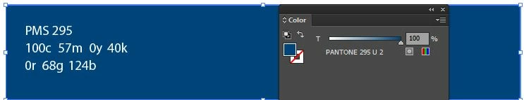

    The window that is below is a the style guide.I think I might be on to something here, but Im not sure whats going on. The style guide was sent to me as a PDF, when I open it in illustrator and look at this page with the color specs, the color seems to be closer to the CMYK values they are calling out. But if I copy paste it into my comps its turns to the chalky version of the blue color. You can see from the screen grab that the color mode on the PDF is RGB so I created a new comp and made it RBG and set up the color profiles to match the PDF, but when I copy paste into that new document it still changes to the chalky version. There clearly must be some sort of color setting I'm missing that is causeing this to happen when I copy paste it into a new document, but I am not sure what to look for. Any Ideas?
    I just upgraded to 6.0 from 5.0 but I was having the issue in 5.0 as well. This might be becaue I went to the pantone website and updated all the color books directly from their website so I had all the pantone+ colors that where in our new Pantone+ physical swatch books. So I belive all the versions of illy I have on my machine should all be using the + books.

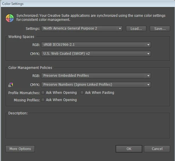

    These are the settings for the style guide for reference. When I created a new document with these same settings and copy pasted the color from the style guide the color changed even though all these settings where the same and they where both set to RGB. I'm missing something here, but not sure what.

    This is a screen grab from the style guide file, note the RGB icon under the 100%
    Now this is what happened when I copy pasted the above color into another document,
    Note the RGB icon is now magicly a CMYK icon...

    These are the book values provided by Pantone and they display the color way off (much more saturated on my monitor) than the color in the book. In the Swatches palette, if I select Spot Colors and choose the Lab conversion method this changes the color on screen and matches the actual book. The Lab values are also provided by Pantone and can be checked by double clicking the swatch and making sure the sliders are set to Book Color mode. Then these values are translated by the color management from the Lab color space to the color space in the document which is indicated in the Show menu at the bottom left of the document window when set to Color Profile.
    On my computer the conversion from Lab to U.S Web Coated (SWAP) v2 gives me 85.14/ 67.04/33.58/ 16.16 but these numbers will be different for each different color space used and the color appearance will also be corrected to the monitor's color space of the user. In this way the color will look the same on calibrated monitors when using the same viewing conditions
    The book method values provided by Pantone will be the same for everyone but the appearance on screen will not match any pantone ink final output because  they are not converted and corrected to any color space. You know that each paper substrate like coated and uncoated have different color spaces (profiles) which describe how the same ink produces different colors on different media. The book method values are absolute and does not take this into account.
