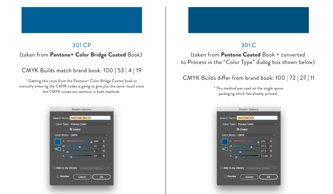

The screenshot below (left) shows the codes listed on Pantone's site. The right image shows the CMYK builds from the Adobe Illustrator conversion method of manually changing the Pantone color to "Color Type > Process" and "Color Mode > CMYK".

The conversion taking place in Illustrator depends on the color management settings.
That is in order to get values that work for all those different media types and printing processes, the color management settings will need to be appropriate for the workflow.
You will need to talk to all these printing providers about the matter and see how you can connect to their processes, so either you do the color conversion or they do.
In case they can't tell you which profiles to use for conversion, you might need to do test prints on all different media in order to find out a color match.
But still they might change something in their workflow (be it the machine, the inks or the fabric) and then you need to adjust your settings as well.
