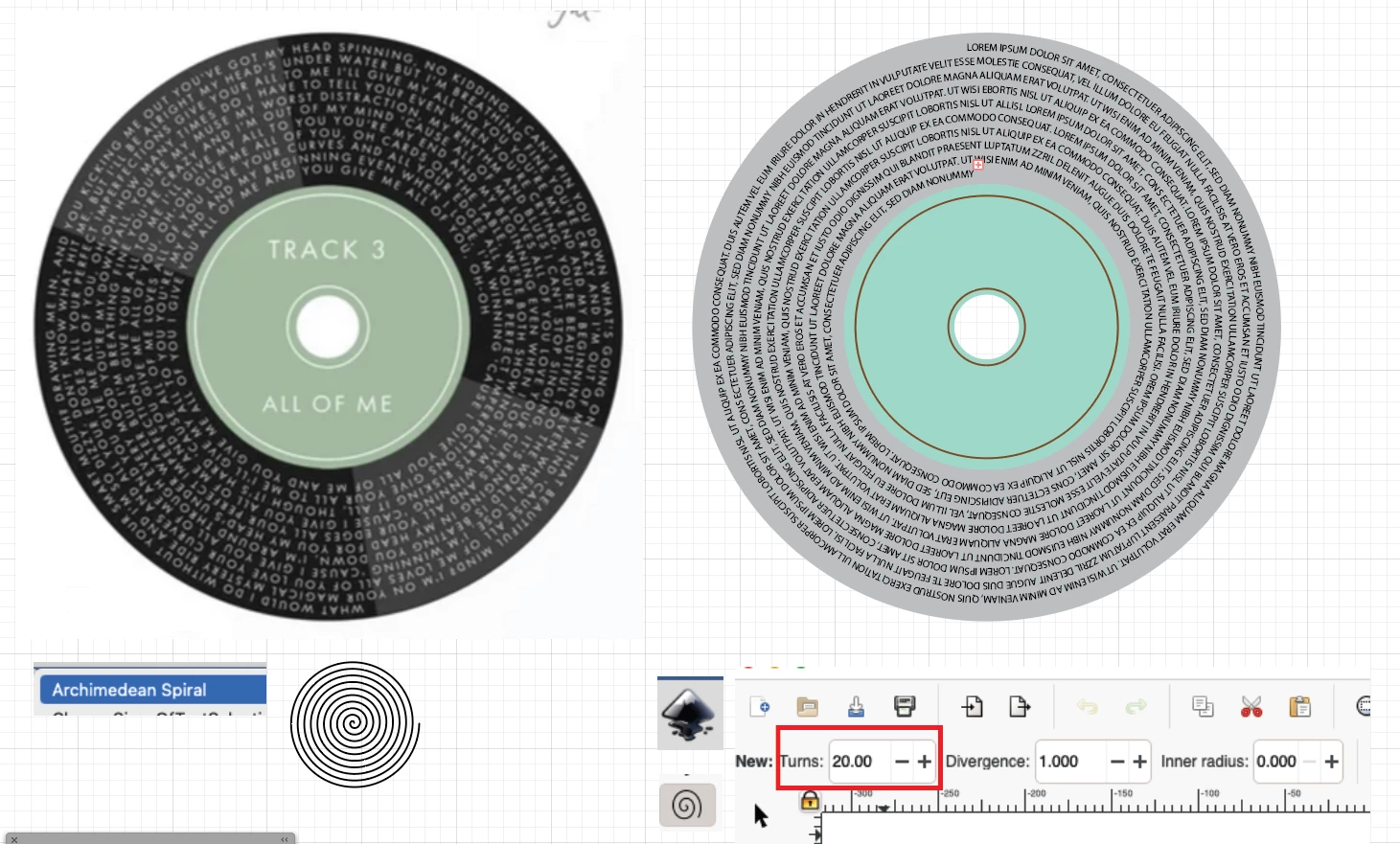

kphotopage
February 23, 2025
I agree with Ton, type on a path and Archimedian Spiral is the way to go.
For Archimedean Spirals, my go to is using Inkscape. You have more control over how many turns to make.
For this particular graphic, the script Archimedian Spiral did not have enough turns.
Here I used 20 turns. Scissor cut the inside and delete.
The only tricky part about this graphic was getting text to read left to right, starting from the outside going inward.
To do this, I resized the spiral to fit the LP record. I also changed the direction of the path.
Lastly, I changed the path to Text on a path.
K
Ton Frederiks
February 23, 2025
That looks good too! But you can also modify the script for the rounding times and radius increment.
