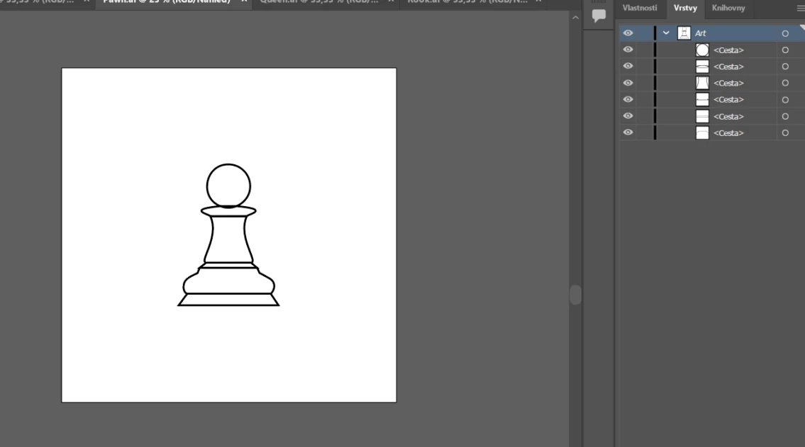

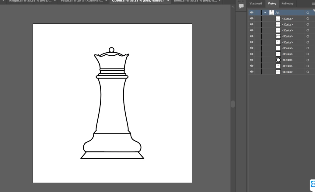

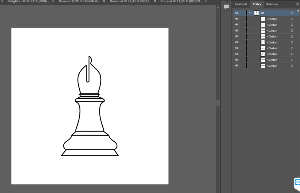

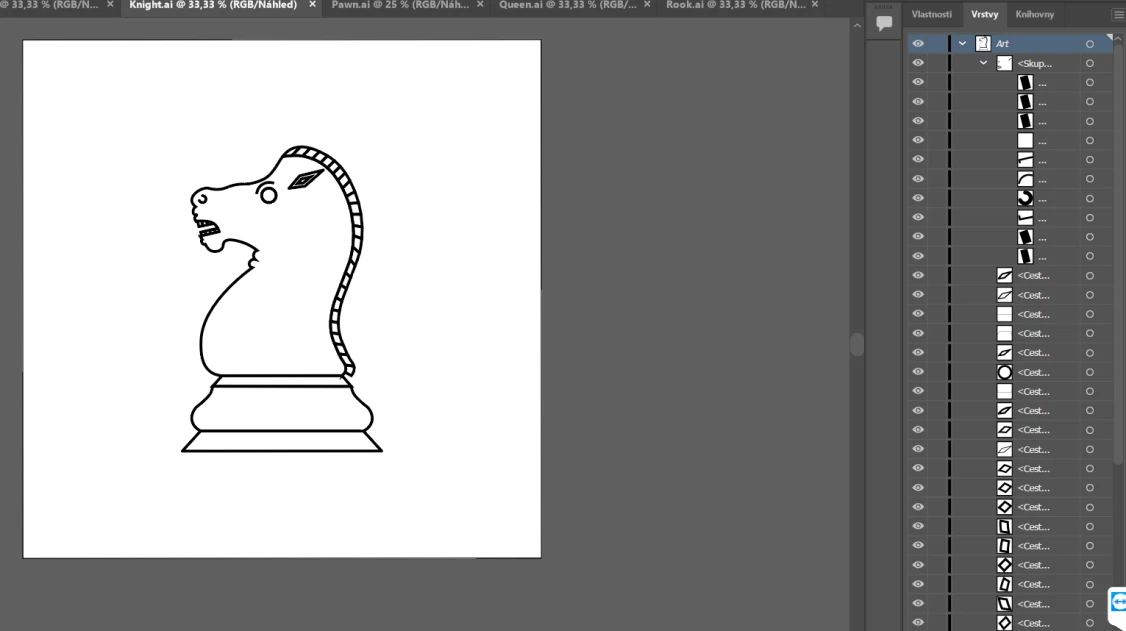

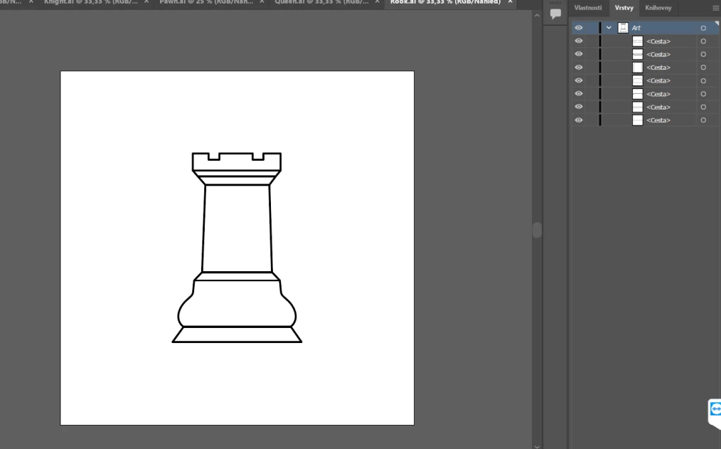

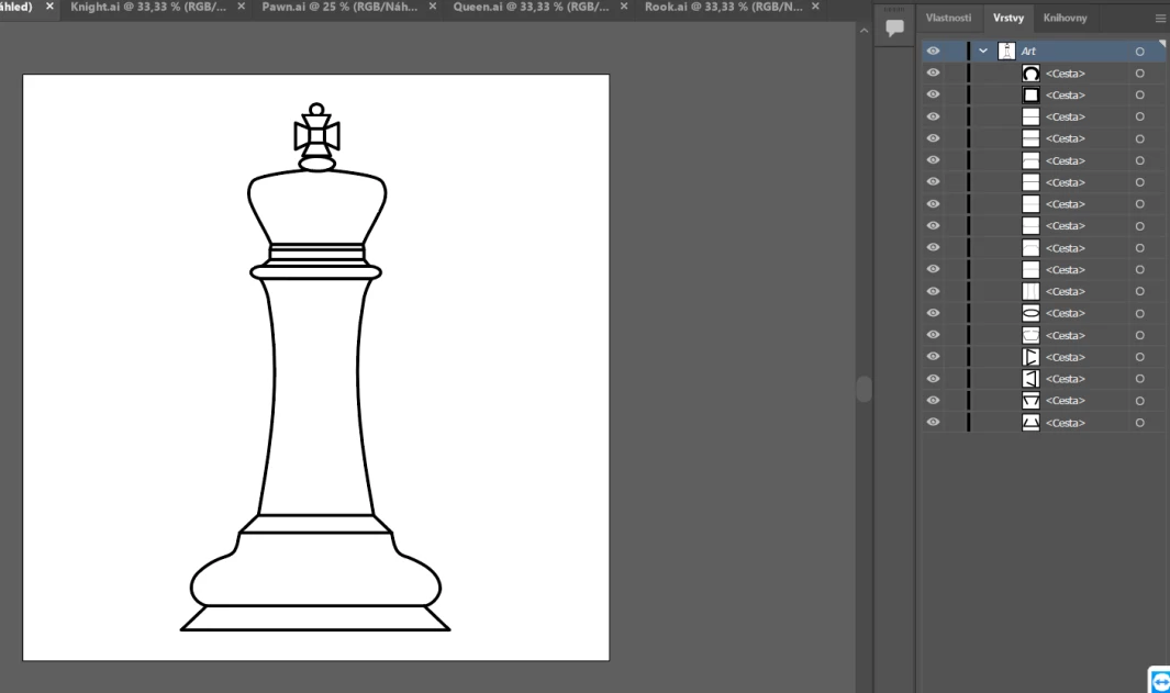

Hi, I am getting "An Illustrator error occurred: 1346458189 ('PARM')" while executing script in illustrator. I am generating random collection of unique arts, the attached script is basically randomly picking between 6 different arts, then its picking if art should be color or gradient and every time its picking the next color from the list at the beginning, then its picking if background should be color or gradient and picking the order of the colors.
