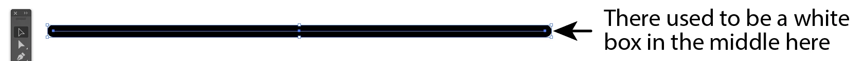

Hello, I've been using an old CS3 Illustrator and recently upgraded to 2019 CC! I notice that part of the bounding box is not showing up when I am using a simple line (pictured). The middle box only shows up if it is any other shape than a simple line. I usually grab the (missing) box so that I can hold alt/option (on mac) while dragging so the line evenly lengthens on each side. The problem now when I grab one of the corner boxes instead of that missing middle box is that while the line grows, the line does not stay in the exact position and it moves up or down slightly. This creates an efficiency issue for me because now I have take the time to again place where I need that line to be.
Any resolution for this to get that middle box back?

What I found when I checked this was that the middle box will appear when either you are looking at a line with a larger stroke (over 15 points) at 100% view or a line as thin as one point at approximately 1500% viewing size.
AONPAuthor
March 29, 2019
Hi Bill, thank you for looking into this for me! I just checked it out based on your comment. In that case, it seems they did away with the middle box then for the small sizes. I will zoom in when I can, I don't typically need to zoom in that far. Also use no larger than 1pt line weights but hopefully I can figure out a way to make do.
