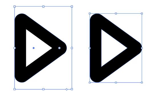

Like I said it is a weird way to expand the Polygon and it does reset the bouning box.
Left: before Unite, right: after.

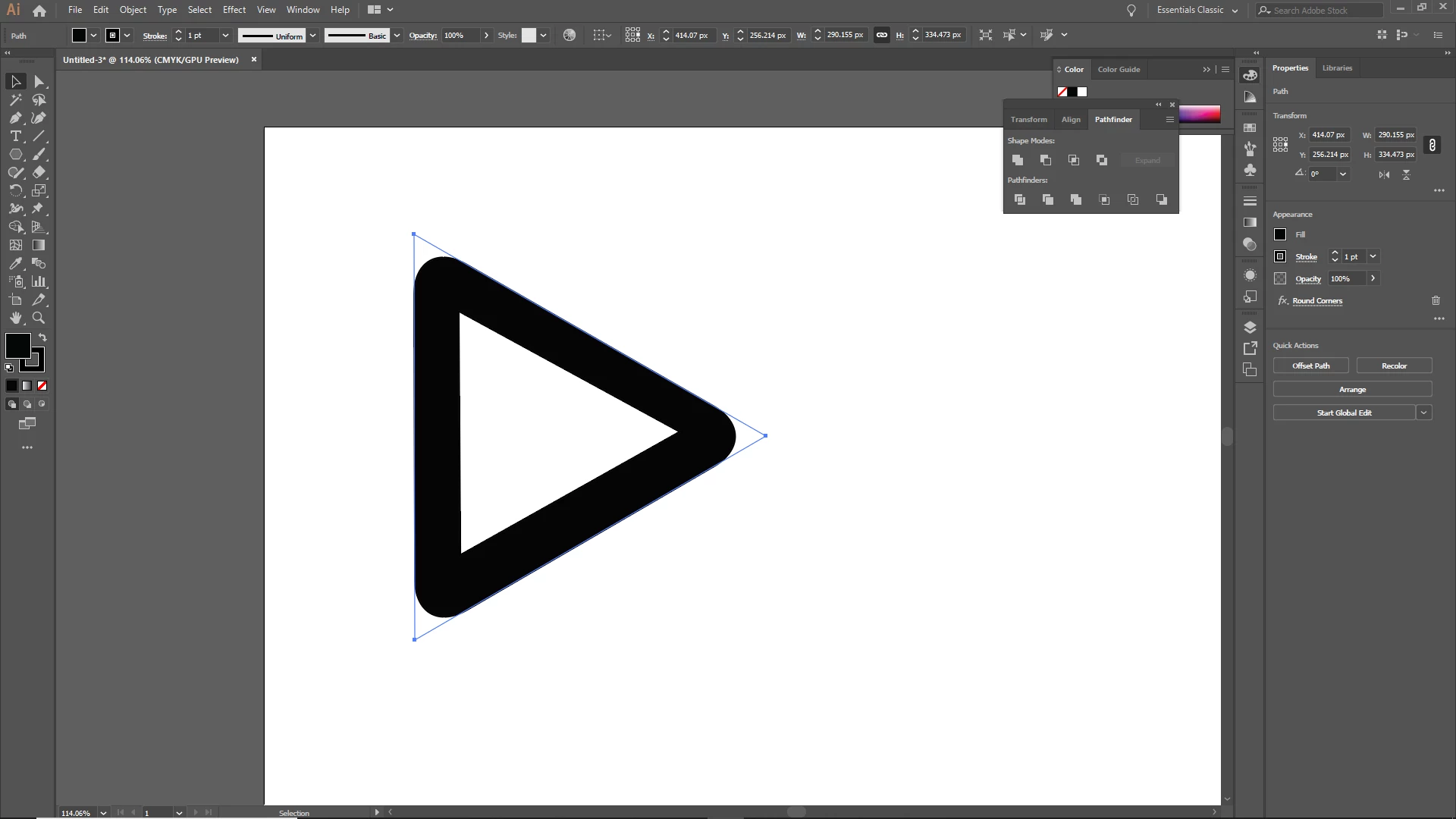

Right, I have rounded the corners with the Direct Selection Tool ( Not used the Effect) - What a Shocker, the unit button still doesnt work. Oh no wait, thats normal for Illustrator CC to clearly have a mind of its own.
Are you aware of any known bug around this "feature" becase right now this is really making my blood boil.
Ton Frederiks
September 28, 2019
Which version are you using?
He showed 2 ways of rounding corners Corner widgets in CC and Round Corners Effect from older versions. He used the CC one, which one did you use?
September 28, 2019
The rounding of the corners isnt the issue, the issue is the two shapes not merging when I tell them to. But to answer your questions: I'm using Illustrator CC 2019 and for the "Round Corners" effect I went to Effect > Stylize > Round Corners. Thank you
