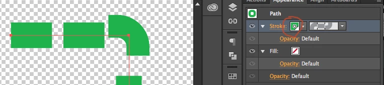

In the interest of always one more way to do something...
Choco_123Author
June 9, 2017
Ooh very nice...that is definitely a different way of doing it. I was able to create the green path I had uploaded with a pattern brush, but it still doesn't let me change the colour of each segment. Thank you for taking the time to upload this video!

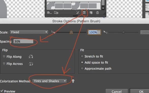

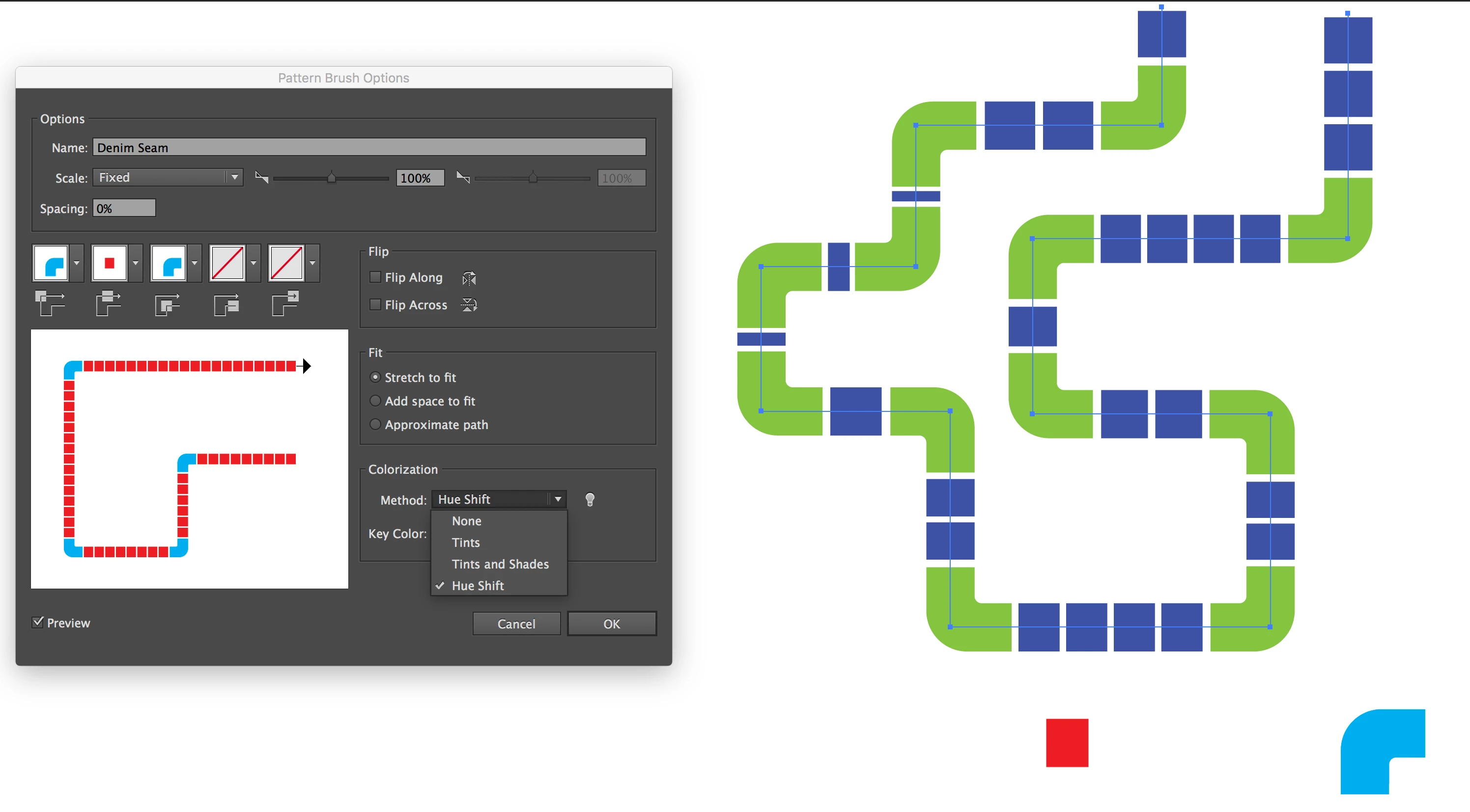

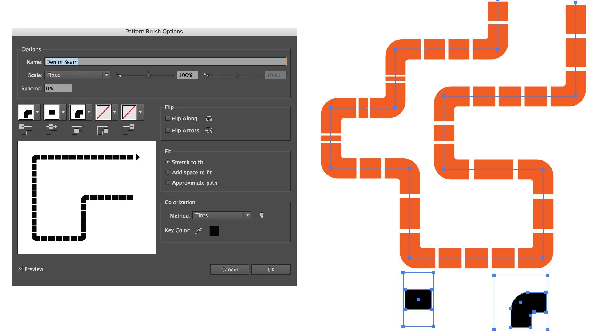

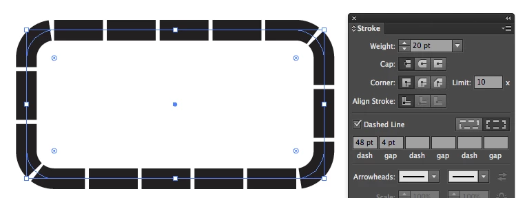

rcraighead
June 9, 2017
This should work with minor adjustments. Too bad the "aligned" dash line approach does not with rounded corners.
Choco_123Author
June 9, 2017
HI! This is the way I created my path as well, but I am not able to change the rectangle segments to different colours...is there a way to do that? Is there a way of making the brush elements into objects so I can modify each segment separately?
rcraighead
June 9, 2017
You can expand the appearance and edit the colors any way you want. You can also set the Brush to "Tints & Shades" or "Hue Shift" and get some funky effects.

Apart from that: try a dashed stroke. And then apply multiple strokes to your path in different colors with different, but matching dashes settings.
Mike_Gondek10189183
June 9, 2017
Hi Monika (or anyone),
Align dashes to ends often does not appear to work on closed paths. Do you have any idea how to get this to work.
When I work on for example a rounded rectangle beer label design and want put dashes around the edge,  I could really use this feature instead of manually creating. I get my design perfect, and then they change the label size a little so I have sot start all over.
Mike_Gondek10189183
June 9, 2017
Fill your patterns with 50 black then
Then change you stroke color
your path needs to have all corners though.
I had the alignment working, but cannto get again and have to go back to work. Try adding a rectangle filled with none.
