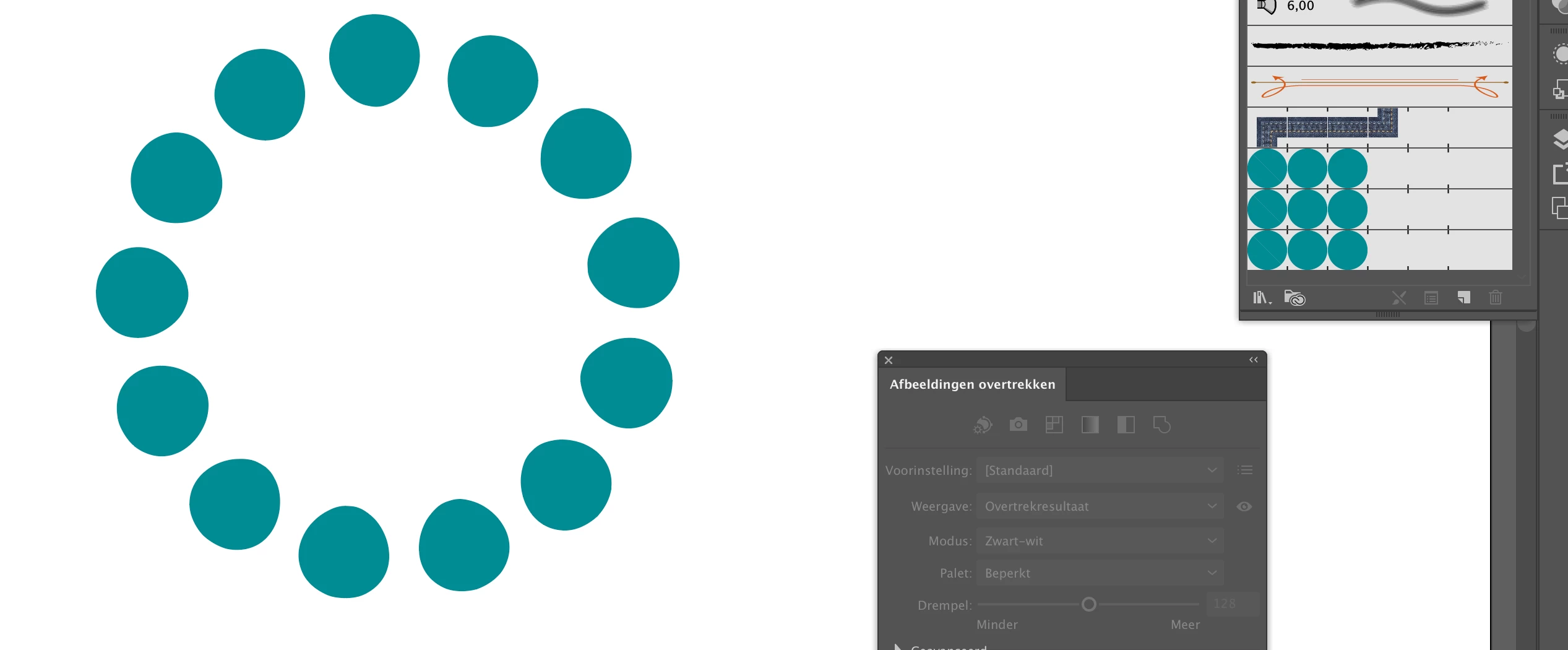

hello,
when i make a patternbrush of my cirkle (filled with blue, no stroke)
Illustrator distort my perfect circle when i put the brush on a new circle as a kind of stroke. The perfect circle is nog an egg.
I made my preferences of my brush ok ('not scaling' 'following path')
kind regards

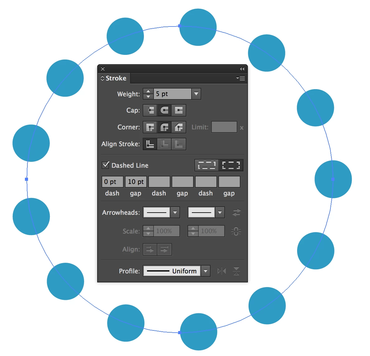

    If you're after  a simple dotted line use the "Dash" option on a simple line. Click the far-right icon right of "Dashed Line" to keep the distance equal.

    The pattern brush will always distort unless you make the circle in a very specific way: Draw a linie. Move both endpoints exactly on top of each other. Apply a stroke with round end caps. Set the stroke width to your needs. Drag the thing into the brushes panel. This point will not distort.
