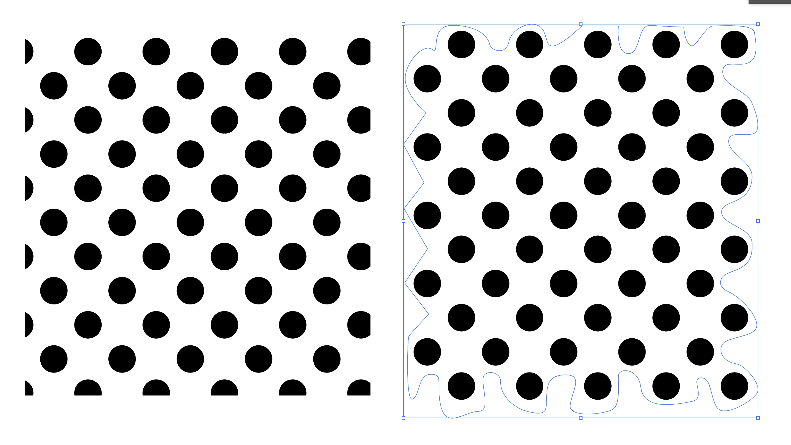

If I'm understanding what you want to do, try the following:
  1. Add your pattern to a rectangle.
  2. Manually trace in and out of the dots with your Pen tool.
  3. Add the Pattern to your new shape.
By default, your dot pattern should line up perfectly with the dots in the original rectangle, so no dot will be cropped.
See attached.
