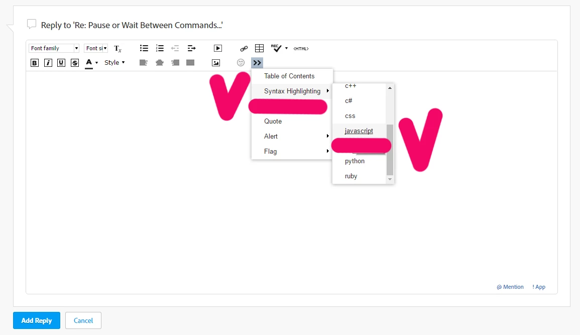

Thank you... I was wondering how to post the code correctly...

ps. Can you format the code in the same way?
Thank you!
