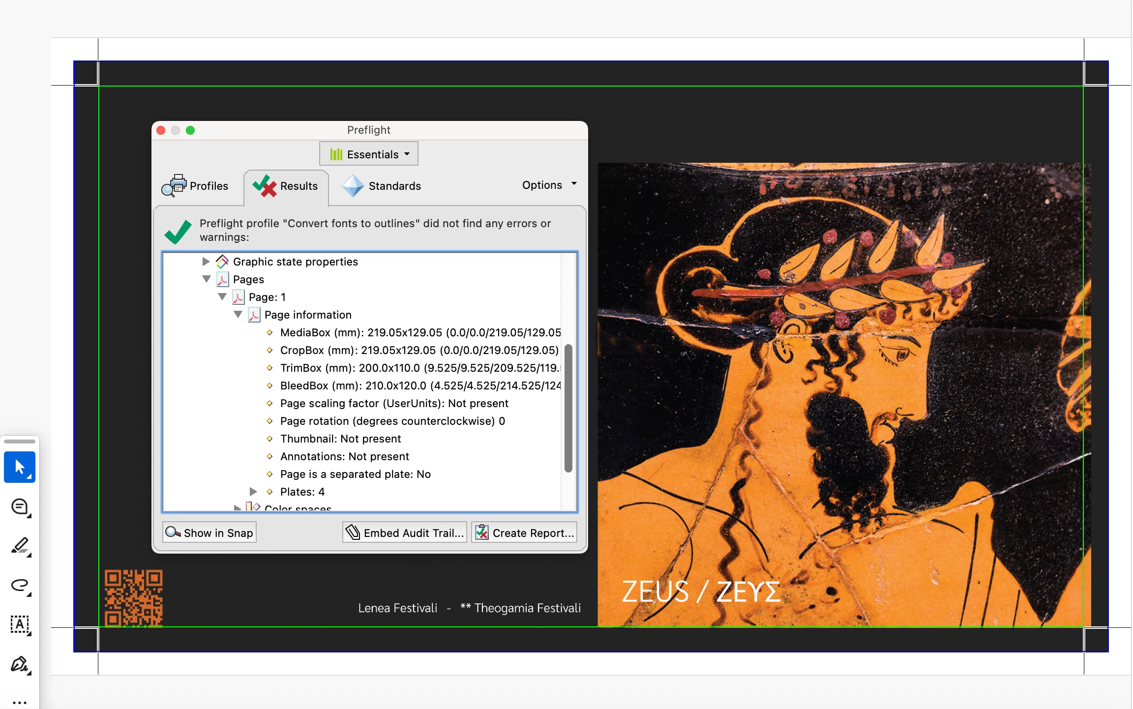

Did you check the Page Boxes in Acrobat > Print Production?

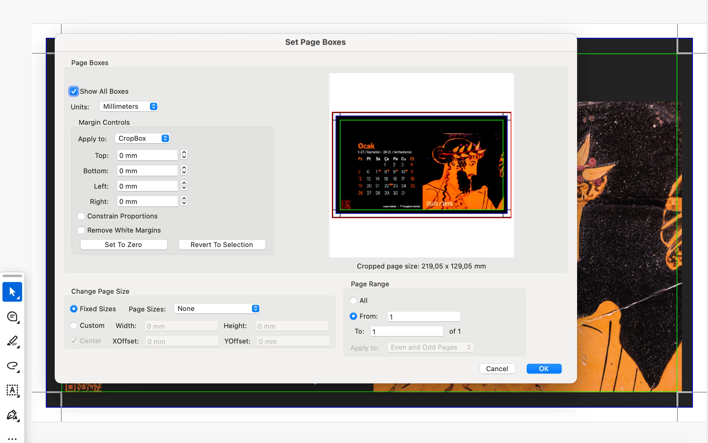

Thank you for your response. The artboard is 200x110 mm, and the bleed is 5 mm on all sides. The TrimBox and BleedBox areas in the PDF are exactly as I want them. However, as can be seen in the image, the MediaBox and CropBox are 219x129 mm. 219 mm is larger than A5, as A5 is 210 mm. After cutting, the remaining paper should be 200x110 mm, and it seems this will match the TrimBox. But since the person doing the digital printing will choose the paper based on the MediaBox, they will consider A5 to be too small and select a larger paper. I want them to choose A5 paper because otherwise, there will be paper waste and increased costs.
Thank you!
