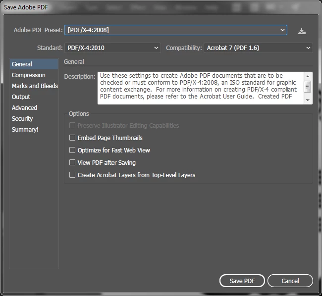

But saying that other Illustrator files print well, I would concentrate on that file. Please save the file from Illustrator as a PDF/X file and import that one to Indesign. You may also try printing the Illustrator-PDF prior to placing in Indesign.
See the screen shot from the Illustrator Save-as dialogue:
You still need to check this: Is there a black background and the foreground is set to overprint?
