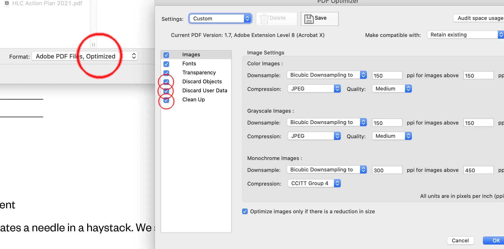

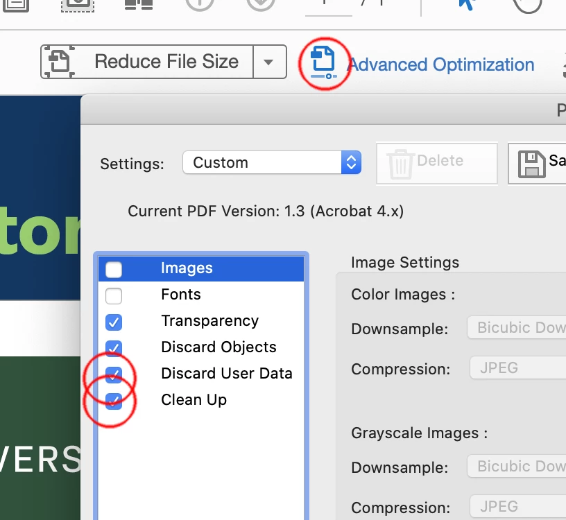

Your method is good Morazan of using Acrobat extract pages. The problem is extract pages leaves the data of other pages in the pdf, just hides the pages. Though their rip will likely see these as 1page file your file sizes are huge for transfer.
You will need to do advanced optimization. unfortunately you can not run the on multiple files like reduce file size. Maybe there is a way to change the default reduce file size.

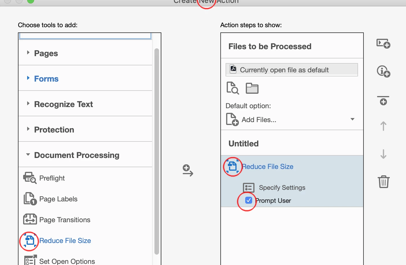

Mike_Gondek10189183
April 17, 2021
You can make an action to reduce file size, which allows you to add multiple files then you have access to this. Use New Action to create one.
