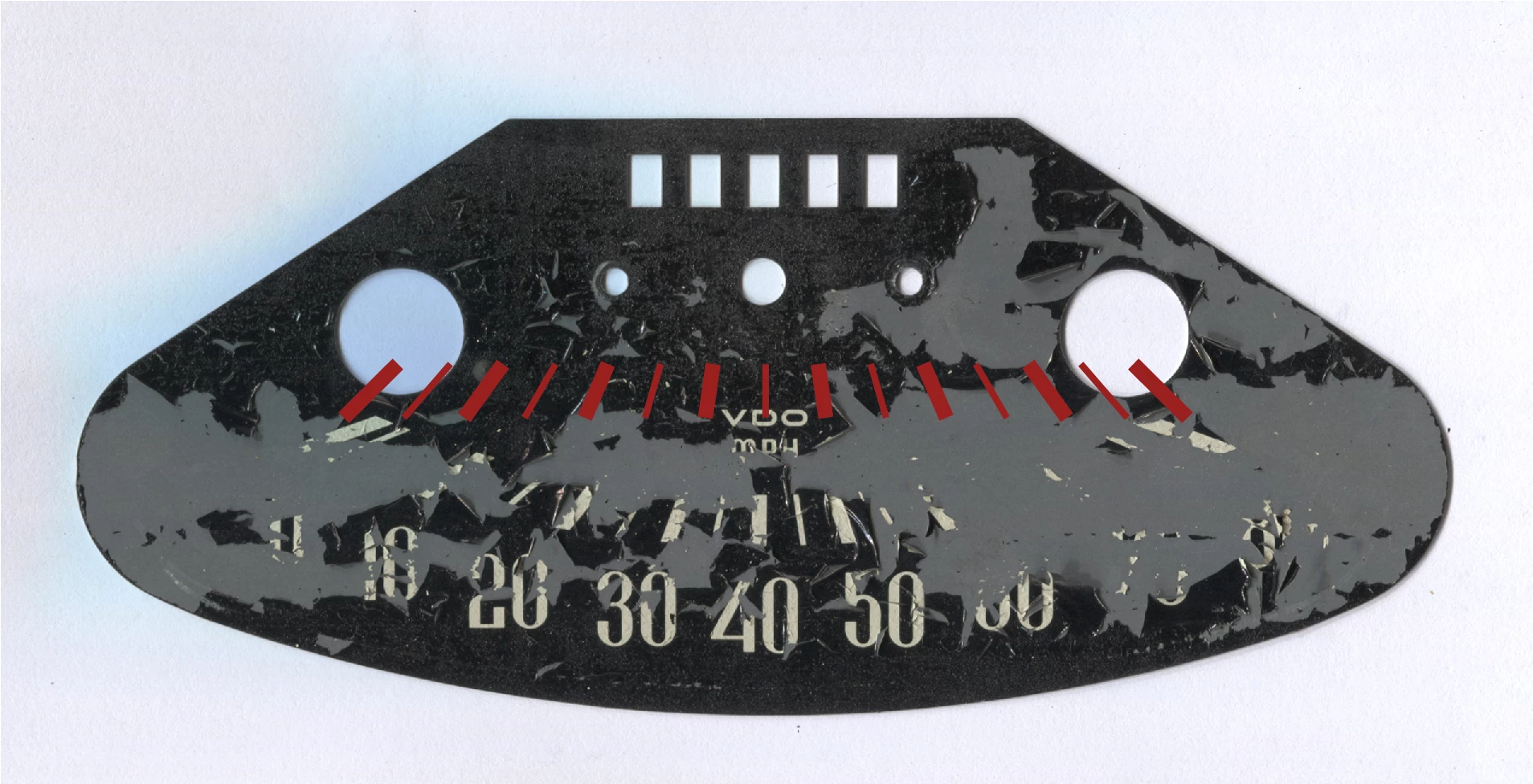

Prior to the CC 2018 version of Illustrator, I was using the Perspective Distort Tool to recreate the hash marks for Speedometers (and other dials) that I need to re-create artwork for.  Now, the Perspective Distort tool seems to be just one tool which is the transform tool.  I am unable to figure out how to distort of group of hash marks.  The video's and articles that I've read all seem to deal with using perspective distortion on a single piece of artwork.  When I use the free transform tool to pull the corners, they all move in one direction.  I need to move them in both directions as a group WITHOUT changing the width or length of the marks.  This is the original dial that I'm re-creating.  Help in explaining the new way of doing things would be most appreciated.
For those of you that are interested, this is for a 1960 Heinkel Speedo.  I need the hash marks evenly spaced (although they are of two different widths to represent the major and minor hash marks)  There are 15 hash marks in total.

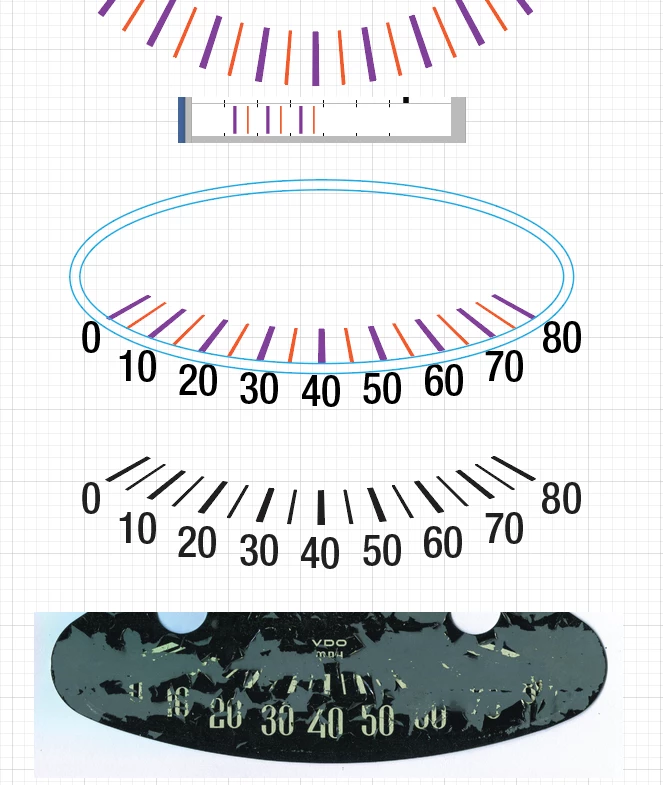

Jber, Hi.
Here I first created a Pattern Brush and stroked a circle.
Then expanded the stroked brush and deleted all the extraneous ticks
Next I created 2 ellipses to be use as guides.
Group your tick marks and with the Free Transform tool, adjust to fit your guide ellipse.
Create your digital text frames and place.
Hope that helps.
K

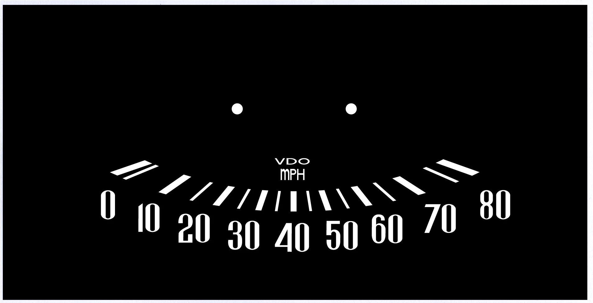

It makes perfect sense now that I've read all the replies.  The customer did make one change and I noticed that Jacob caught the difference between my description and the .jpg I put up.  The change went from "evenly spaced hash marks" to "as originally placed on the dial".  In that respect, I think the brush would not have worked.  I'm not sure how to mark all 3 of these replies as "correct", but I'm going to try because they actually all are correct.  Here is my final work.  I ended up having to create the font for the numbers which was a pain and is the story of my life lol.  You don't see the large circular cut outs or the rectangle cut outs across the top as that part isn't required.  A film will be created from this artwork and placed on the physical dial, although it's not would you would think of as a "sticker" as there is nothing to peel off.

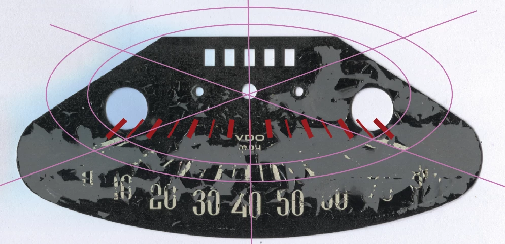

What you see in post #4 by Monika are basically a few of the lines from the centre in the lower part of the central hole as in 1) and then the two ellipses one scaled from the other as in 2); it was posted 3 minutes after my (first version of the) 1) - 3) suggestion in post #3, so we were thinking alike and posting in random order.

Thanks! I was able to figure out what I was doing wrong with the Free Distort (why it wasn't working for me).  Now, my problem is the hash/tick marks are not "laying" down properly.  I need the stroke to look as though it's flat side to side, as shown in the .jpg AND I need to be able to Warp it to the Arc shape and I just can't seem to get it to work.  Any Suggestions? or down right step by step instructions would be highly appreciated.
Thanks.
This is the dial I am trying to re-create and the red hash marks are what I managed to do so far.  My strokes and effects are disabled in general pref.
Monika Gause
August 13, 2018
I doubt that you will reach your goal with distortion.
You might need to do some real construction:
