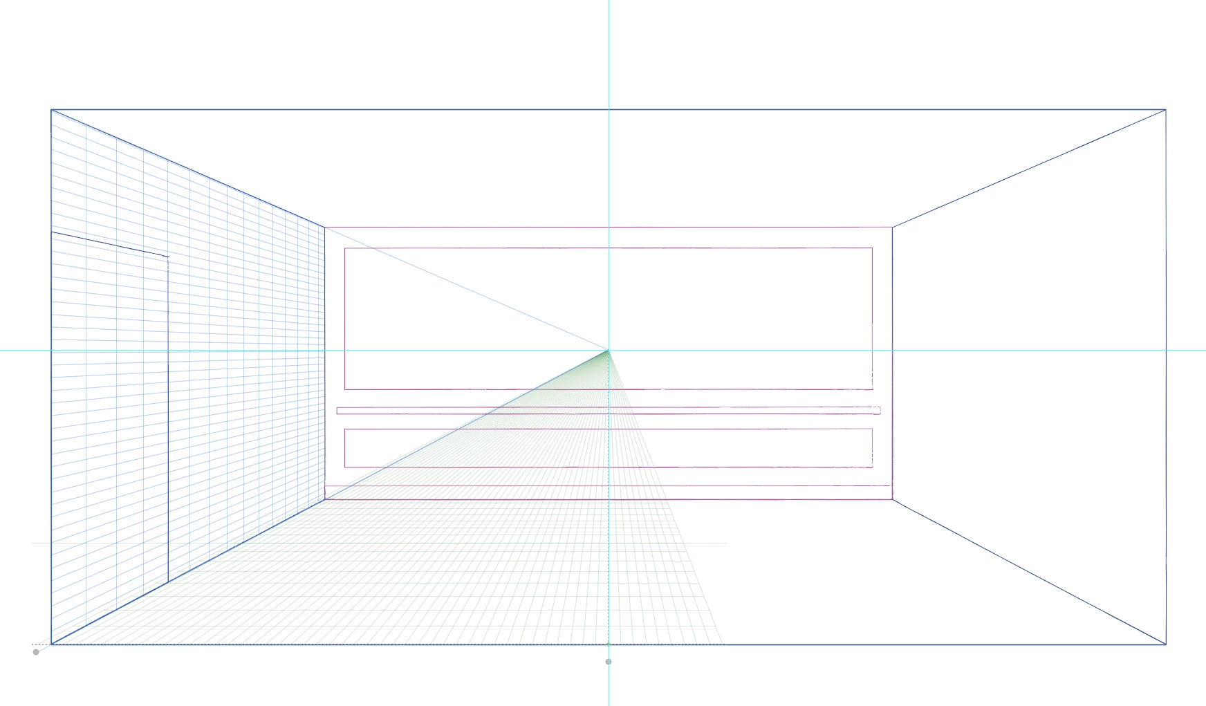

I need help creating a perspective grid for an interior room that has a flat back wall. I believe it ought to be a simple 1 point perspective but I'd like it to have grids for both the left and right wall, (floor and ceiling grids as well would be a great bonus!) How do I define this type of grid?
I seem to only get the Left Wall and Floor in the standard Illustrator 1 point perspective grid. Thanks for any help!

you can draw on the opposite side of the wall even if the grid is not showing, then use the perspective selection tool to reposition the nodes wherever you want

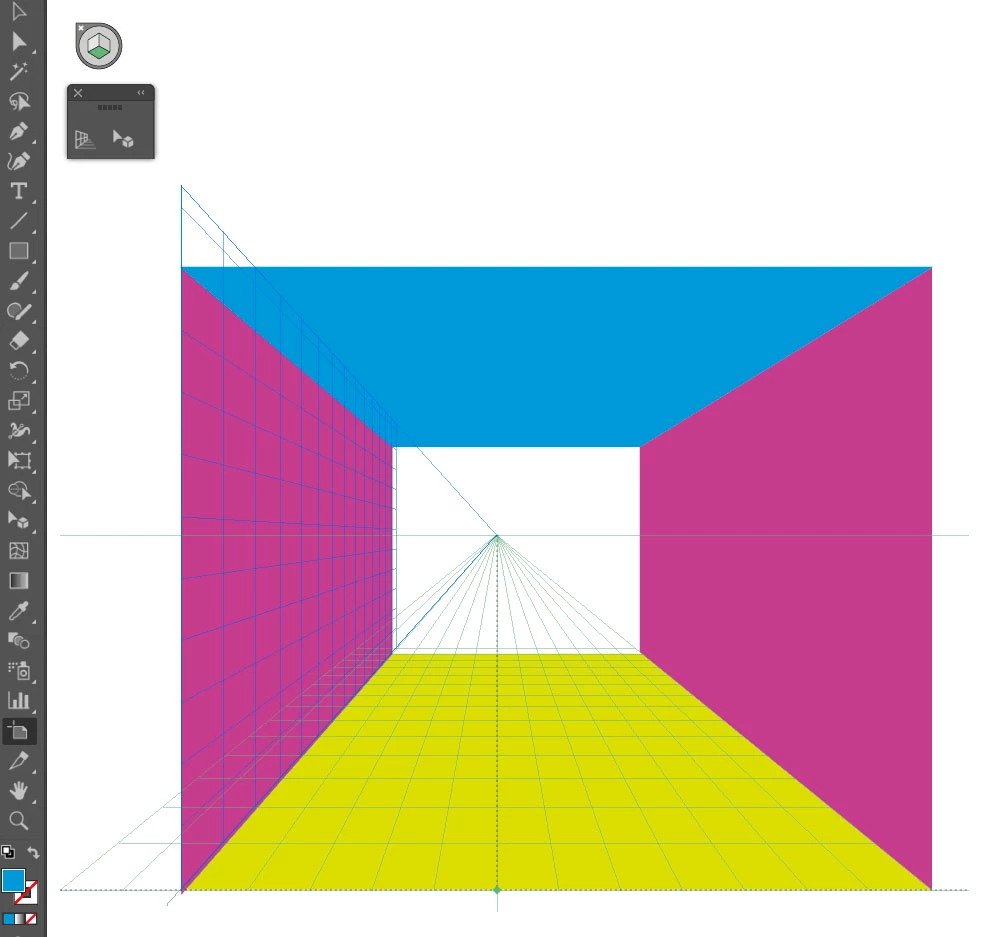

How do I get the green floor grid to move over far enough to the right to place objects on my right wall? The grid seems to be a boundary.
I do see that I can place objects in perspective on the right side, (this is great! Thanks) but it lands along the edge of the green.
Tommy D
Tommy DAuthor
February 24, 2020
Actually, I guess I can achieve this by way of "Shift, 5" to slide the objects back to the right wall. Is this my best method?
