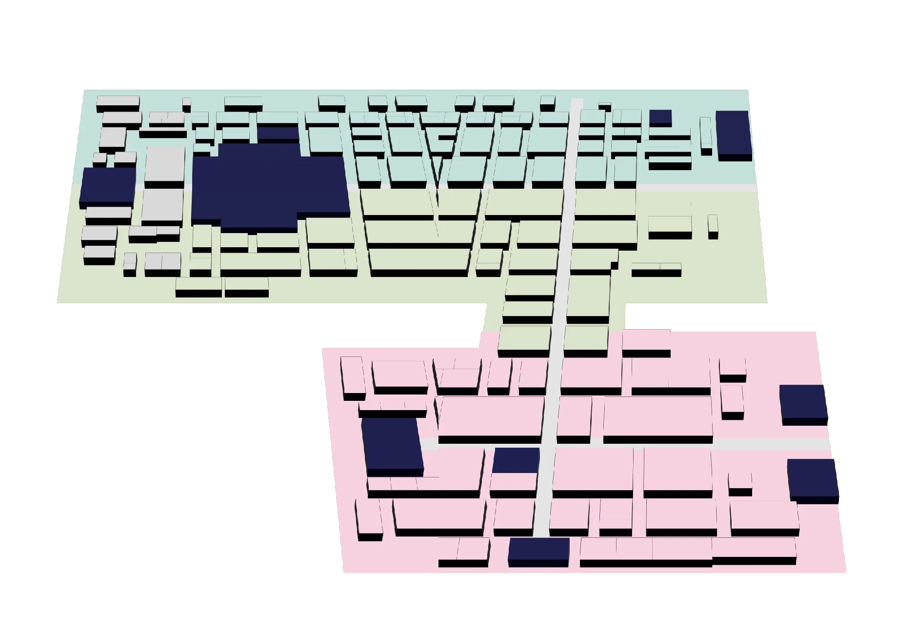

Is anyone having any problems using the 3D tool in illustrator?
The perspective is almost in reverse. Not sure if I am doing something wrong, but I have never experienced this before.

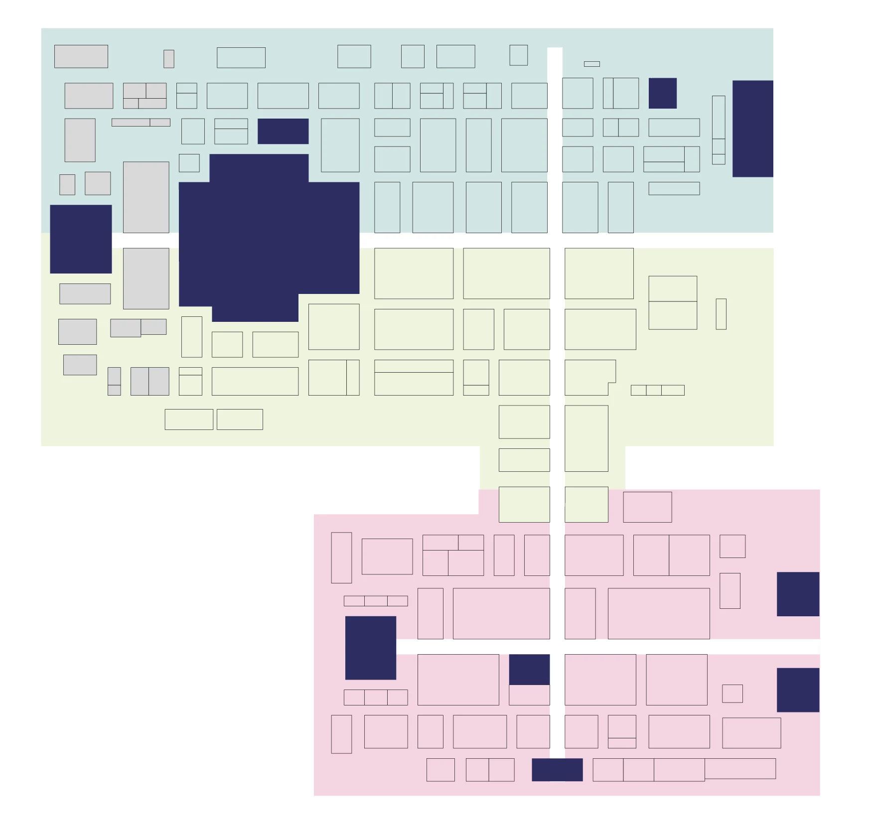

This is the flat image without 3D added.

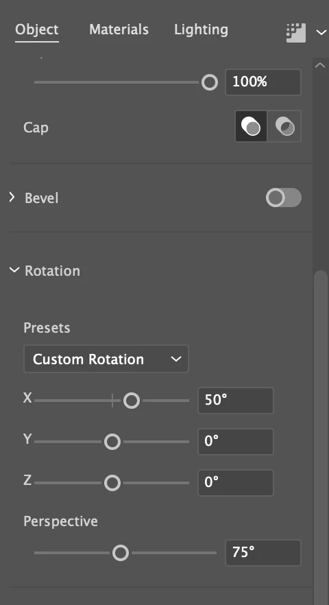

 These are the settings used
