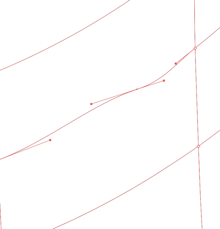

Phantom artifact in mesh object and kinked lines
What is this??
I have uninstalled and reinstalled Adobe, settings completely reset, built entirely new object, copied this to a new file, and have tried placing the mesh in different locations. Why does it do this?
First it was the kinks in the mesh lines that I could not sort out and just dealt with, then not being able to change an anchor from a corner to smooth, now I'm getting color gradient objects floating. This is not only in this file.
What am I doing wrong with the mesh tool? I've done 15 objects so far and I keep discovering new maddening issue not stated in the forums.
Kinked line and artifact. Kinked line is not impacting the artifact, only moving the center of the mesh point.

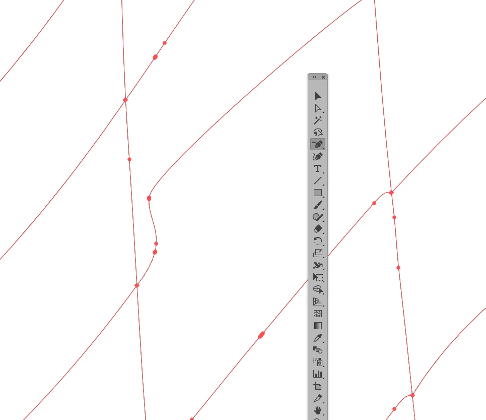

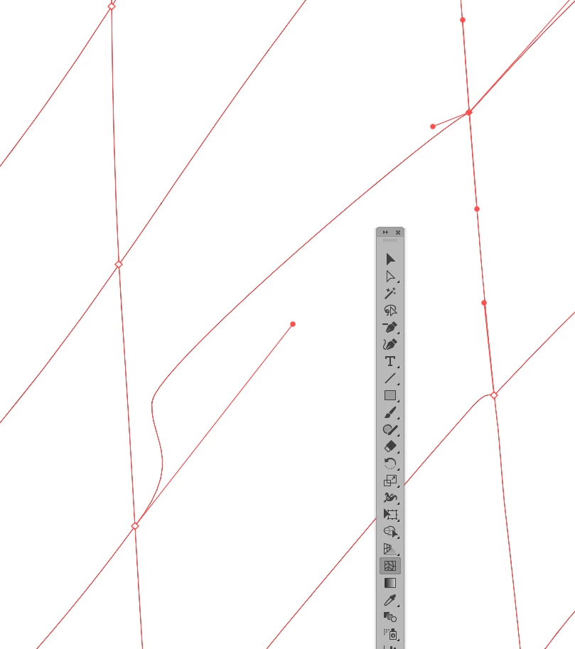

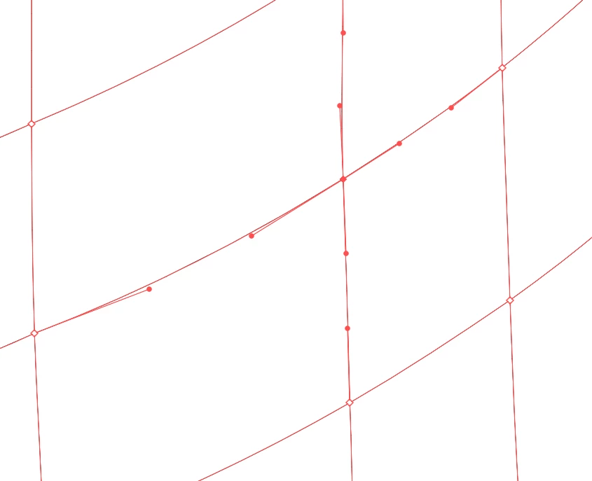

If you select the add or remove anchor points tool (the pen icon with a plus or minus), you will see that there are more additional points in your mesh than can be selected with standard mesh editing tools. Remove unnecessary points and the problem area on the object will disappear.
With the same tool (add anchor point tool) you can add an additional point to the cell edge without creating additional cells.
but this point will only serve for additional transformation of the cell; it cannot be filled with color.
Monika Gause
October 17, 2024
Just click on them with the remove anchor point tool and they will get deleted.
