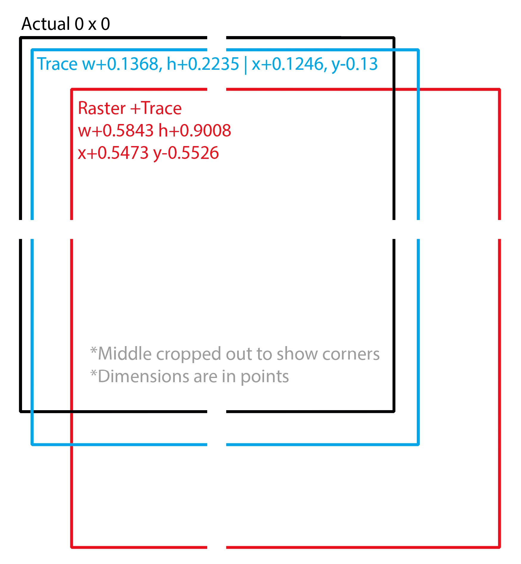

Chris.SAuthor
Oct 23, 2024 4:41 PM UTC
Thank you @m1b !  The line below is what I was looking for
 group.pageItems[group.pageItems.length - 1].remove();
 Coincidentally, it appears going directly to .trace() and skipping the .rasterize() beforehand produces a result that is a bit accurate (raster produces a larger frame and larger offset), as shown in the attached screenshot. Not sure why both methods shift it down and to the right a bit, but with the trace alone method it's less than 0.25pt, so I can live with that... or shift the results with an offset.
Assuming this is probably the best/fastest method to figure out where the image bounds are, excluding white and transparent backgrounds with Illustrator ExtendScript, or any other ideas?
