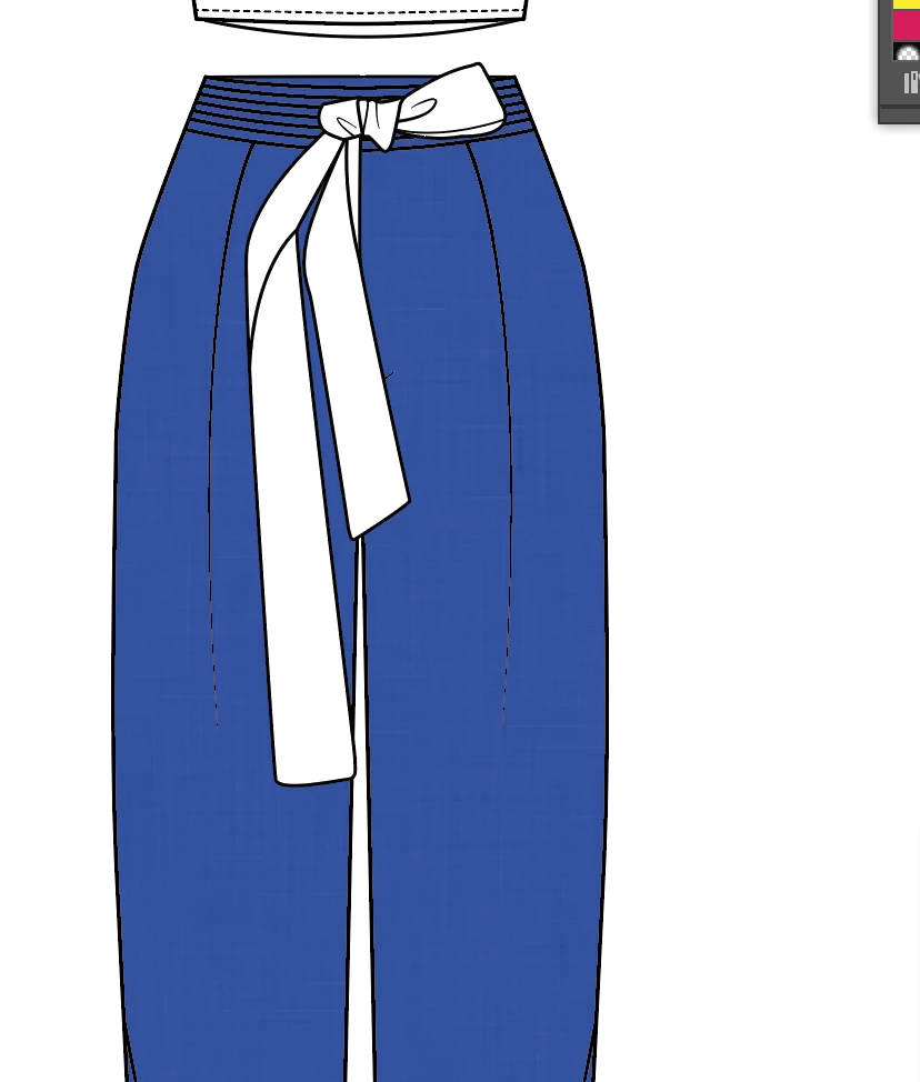

I'm trying to fill in these design flats but whenever I do it make the strokes on layers above look pixelated and have a white outline? I don't have pixel preview on. I've tried everything and just can't figure out what's wrong. I have to share it as a .png image in an online presentation so printing will not fix anything.

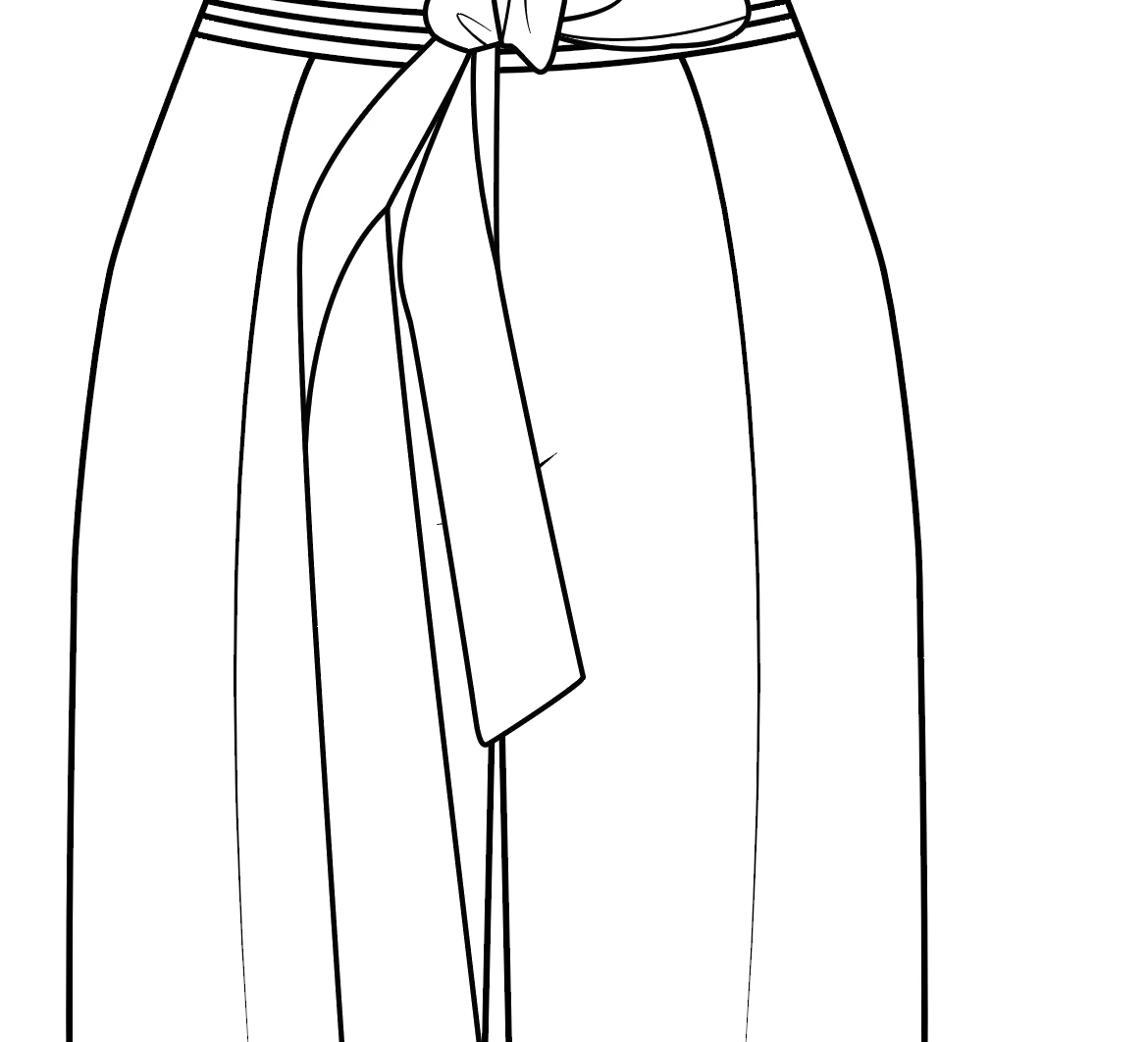

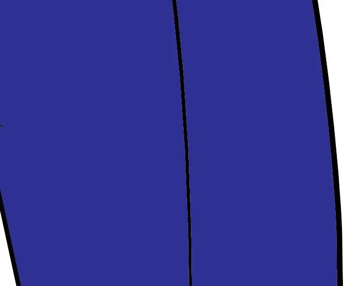

I am also having a serious problem with this on my computer. I've never had an issue like this with illustrator before. Its not just with black lines its any lines at random and makes the artwork horrible. I'm attaching a PNG with a few different default brush strokes with my pen tablet which shows that it also appears on my output files. I have anti-alias on and GPU off (which I have seen in other posts may fix this problem but it does not). Changing the blend mode will not work for the files I create. Adobe, is this a known issue you are working on?

This is generally how the edges of 100K objects look in CMYK color mode.
When you print in offset printing, it will usually be gone.
But it might carry over into exported raster files.
If you want this gone, I would suggest you post it on Uservoice.

You are a life saver Monika_Gause! I create for print so often work in CMYK and have never encountered this problem on screen until now. I will work in RGB until I can convince Adobe to fix this issue. Thanks again! 🙂
