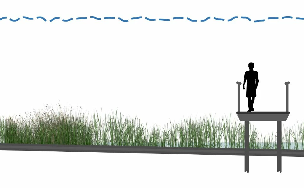

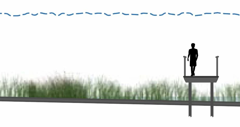

    Hi, OK if we forget all the ins and outs of copying and pasting, here's what happens:
    If I simply open any bitmap in Illustrator CS5 and view it at 100% by default, it looks jagged.
    The same image when viewed at 100% in Photoshop, looks smooth.
    This is true for any image resolution and size.
    I've done this 1000 times in CS2 without having this problem.
    I've tried ticking Pixel Preview under View, no difference. Anti Aliased Artwork under General Preferences also dont help.
    See samples below. If you look closely at the bottom image outlines (screenshot from Illustrator at 100%) , you'll see its jagged, not as smooth as the top image.
