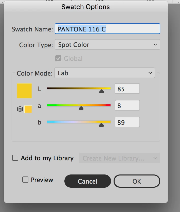

    using newest version, 23.0.2.   Swatch options set to "use LAB values of book manufacturer".

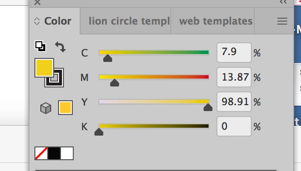

    Color settings set to use US Web Coated Swop V2.  Here is what the newer pantone plus solid coated library builds the PMS 116:

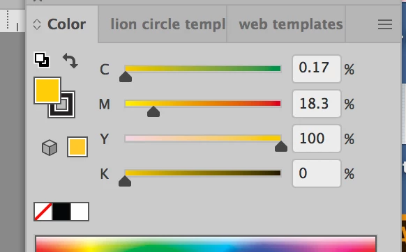

    If I open a new doc and select the same spot color from the older pantone plus library, without all the new colors pantone has released in 2016...,  see the spot colors are built on LAB, instead of Book Color.
    Color was more accurate with original version.  This converts to process as the following build:
    Much more accurate color builds in 2015 than we have today.  Any thoughts?
