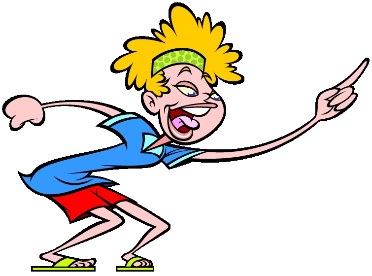

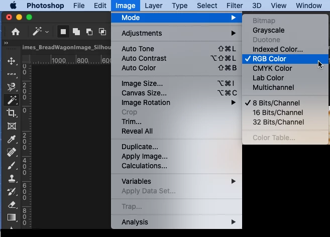

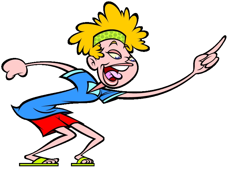

May 16, 2020 8:56 PM UTC
The image mode option(s) may resolve your issue.
I changed my 8-bit (transparent background).png image file from indexed color to RGB color in Photoshop (CC) and dragged it from my desktop into an opened Adobe Illustrator (CC) .ai file. The transparent background remained after that procedure.
Monika Gause
May 17, 2020 3:13 PM UTC
Please show.
Steve-S
May 17, 2020 8:17 PM UTC
IMAGE MODE - Indexed Color
IMAGE MODE - RGB
