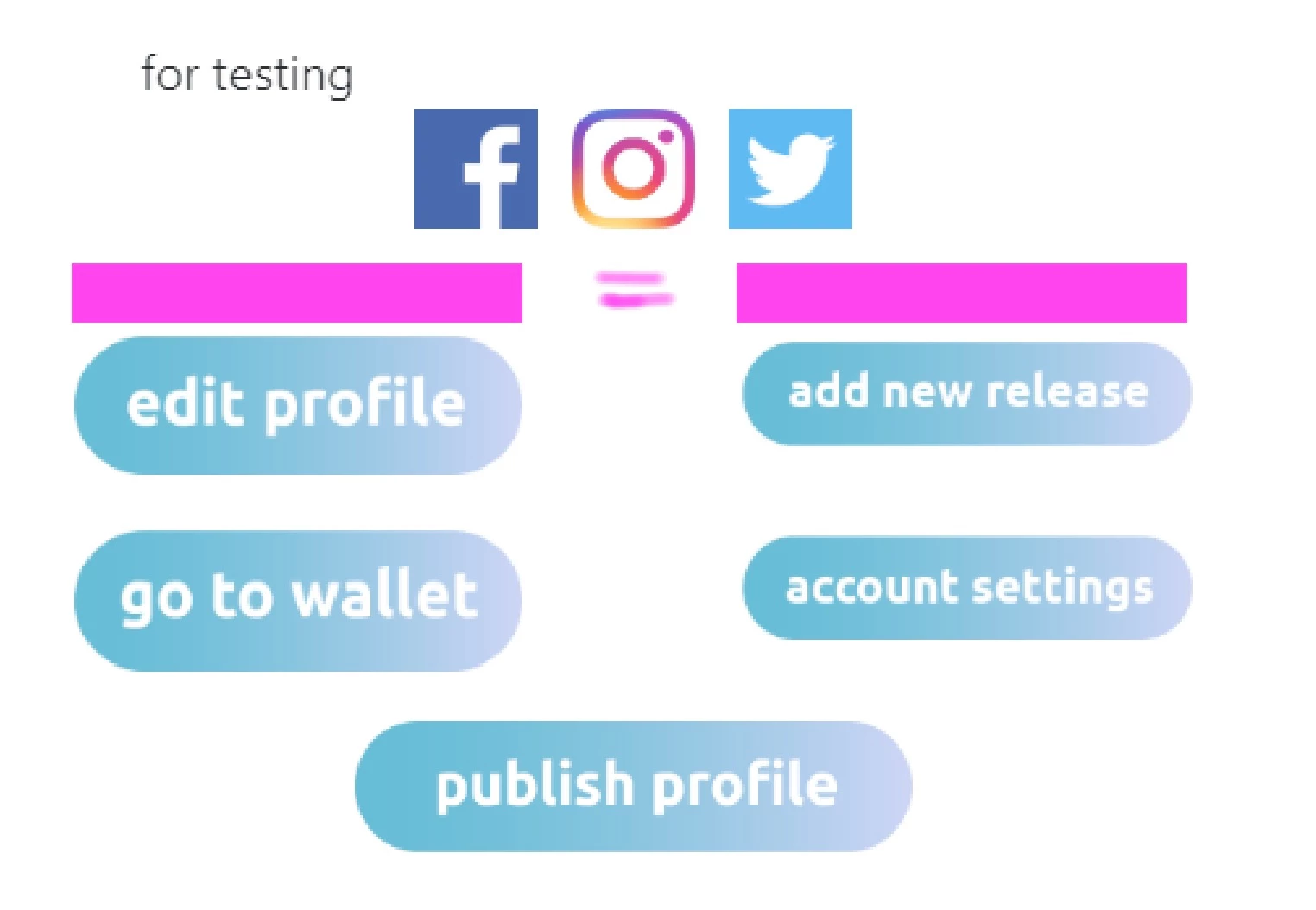

    Looking at this again, I'm realizing that your buttons on the right are just longer than the ones on the left. And they appear to be resizing to match.  Check the dimensions of your button shape.  See above where Grant is pointing this out with the pink line.  I just didn't register it yesterday.  But yeah, you're giving them different widths of buttons.

    Grant H
    Jun 12, 2019 11:57 AM UTC
    It looks like (he) is placing them in a container that is constraining the width and thus reducing the height.
    Grant H
    Jun 12, 2019 12:00 PM UTC
    Pink = Pink hence my comment:

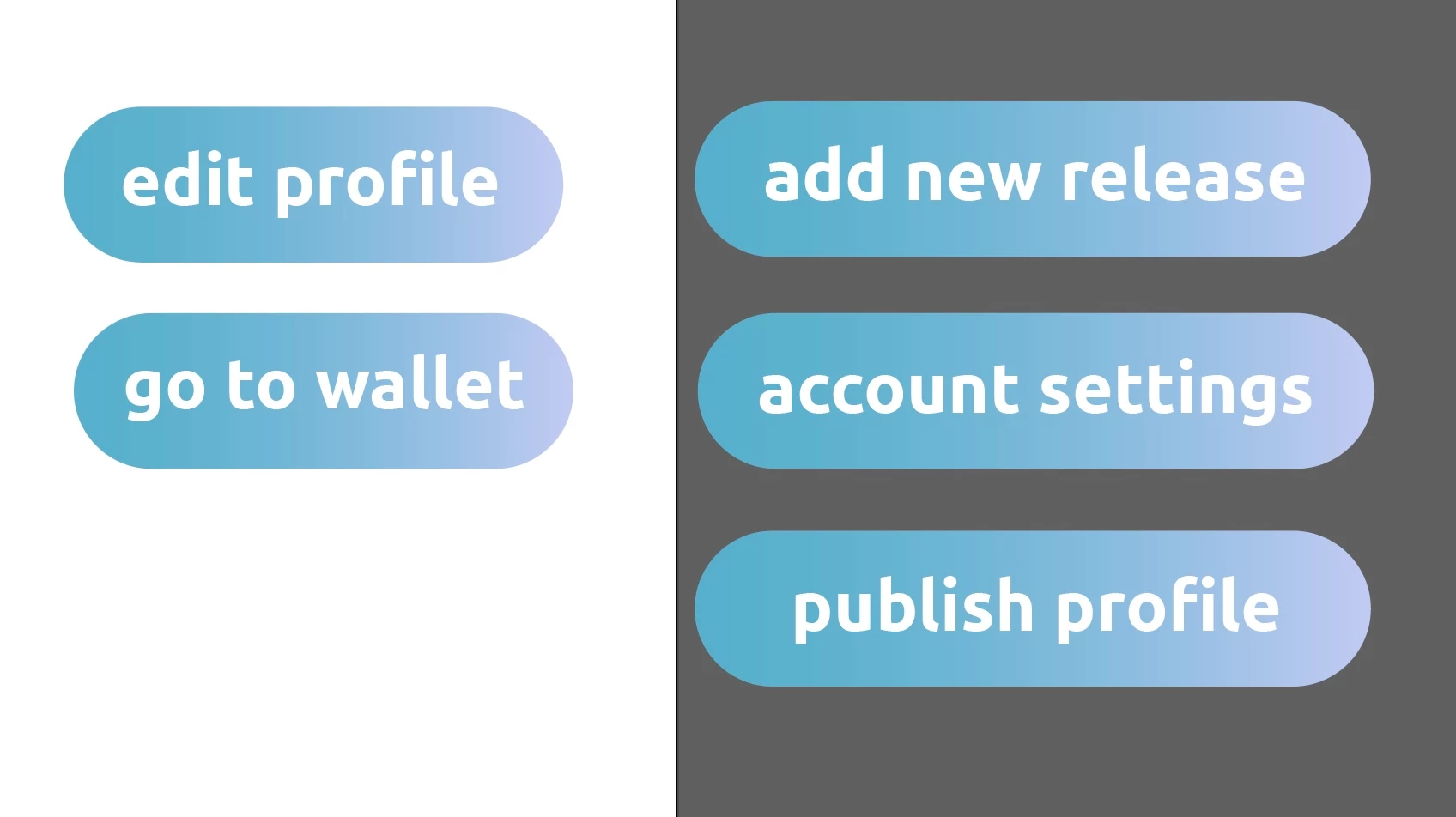

    Here is what they look like in my AI file...

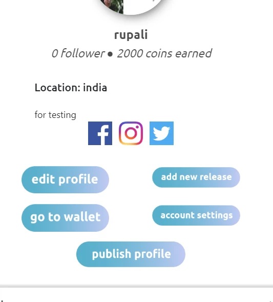

    here is what they look like when the dev uses them...
    Im using illustrator and he tells me he is using 'react for frontend and bootstrap, css things for design the layout'
