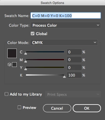

to break it down: CMYK = Cyan, Magenta, Yellow, blacK. Those are the four inks you printer will use on the press to print your file. That should be the color mode of your document. What you printer is asking is that you set your text to use a swatch (in CMYK mode) that will use black ink only, not a color mixed from all of the colors.

Hi. If you're working with a CMYK document, you can use the Black swatch. That Swatch composition is 0C 0M 0Y 100k.

Color management nees to be set up properly.
The document color mode must be CMYK
The text must have Black 100% applied. Do not set it to Multiply. If you want to make sure there is no issue with registration, set it to overprint.
When exporting a PDF, make sure to not mess up color.
Everyone of these items is a full chapter of textbook learning. So maybe you want to get some professional help doing this.
