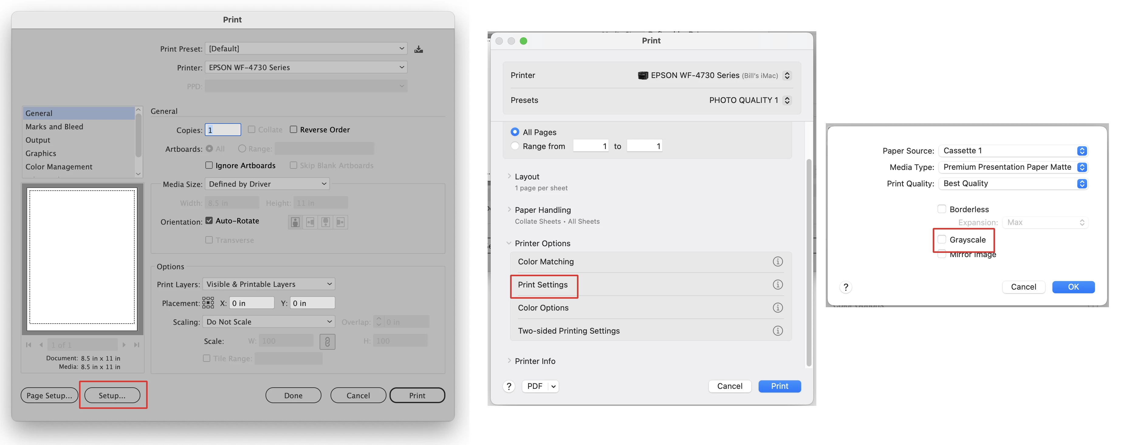

When you say that the color is not coming through do you mean that the colors are not accurate or that the results are a monochrome? If you mean that your output is in grayscale you can check that by following the steps shown in the screenshot below. I don't have the same printer as the one you mention but, hopefully, your printer has similar dialog windows. Click on the Setup button in your Print dialog. Then click on Print Settings in the dialog window that appears. The next window should show if the option for printing grayscale has been checked. If so then uncheck it and then try and print.
Aug 22, 2024 12:56 PM UTC
The color is not accurate. I've tried changing the "color profile" settings in Illustrator before printing + those still don't replicate the color of the illustrator file as it should be. It is not on the greyscale setting either. Not sure what else to change/check!
Thank you!
