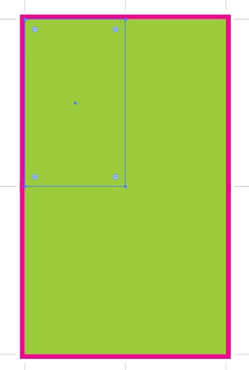

    Also draw yourself trim marks, that you line your ruler up before you cut.
    If your color goes to the edge of your flyer, then add bleed (shown in pink). This way the edge of your white paper will not show even if you are not 100.00% perfect with your cuts.
