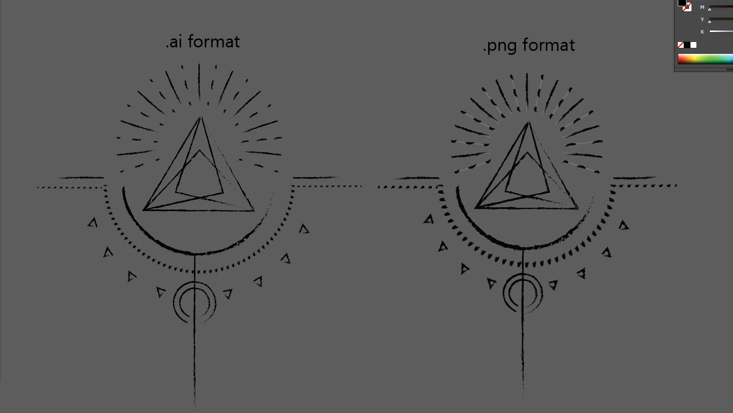

I'm trying to convert .ai vectors in .png on Adobe Illustrator CC 2015. The vector isn't staying intact through the conversion. How should I convert my .ai vector into a .png without being altered. I've attached an example of my problem.

    I finally resolve the problem thanks to Monika_Gause who answered it in another post.
    Looking back at my initial post, I see that I wasn't specific enough about my problem.
    Which was Illustrator exporting dashed lines with solids line behind them. I wanted to share my findings with the community with a short video showing the steps I’ve take to fix the problem just in case someone else searches for this in the future.
