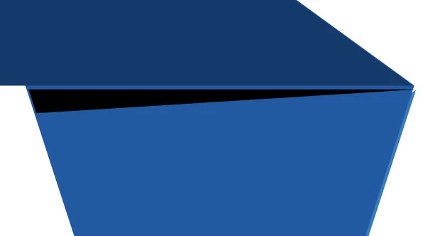

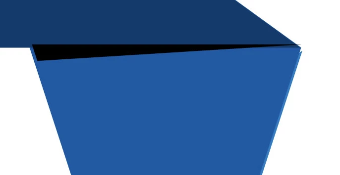

mblaneyAuthor
Oct 25, 2014 1:09 AM UTC
Hey Jacob, yes I was saying basically I need to be able to move the object a third of what the smallest increment the keyboard will allow me to use. If i do use my mouse and put the shape exactly where I want it to be placed, it just moves back to the spot where I could get it closest with a keyboard, here are some screenshots so you can see what I'm trying to do:
I can't get the black triangle to line up up with the edge of the lighter blude colored shape.

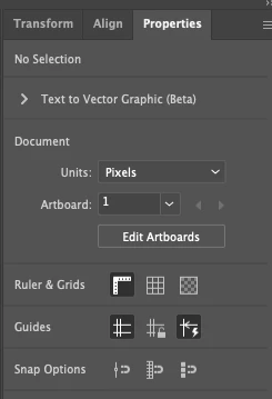

Snap options are ALL OFF
