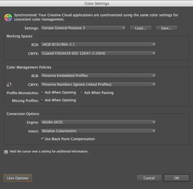

What are your RGB and CMYK working spaces in your Illustrator Color Settings?  What is the Rendering Intent?

Here are my Illustrator color settings. I work from an iMac in case that makes any difference.
Anything I should change in my settings?

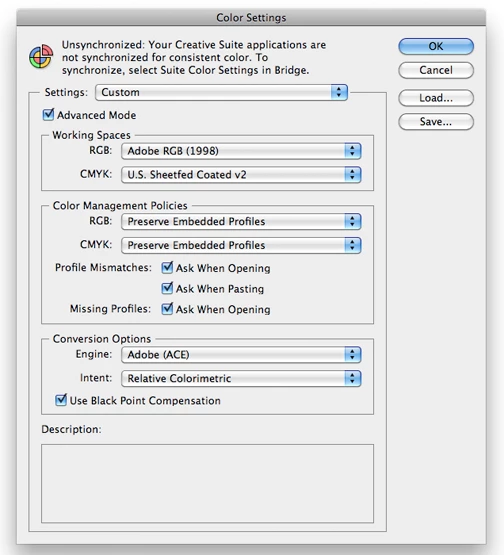

April 12, 2017
Here's what I have...
...not sure, but take a look at your RGB work space and your CMYK CMPolicies.  I say "not ure" because I hardly ever run into consistency problems, but try my settings to see if there is any difference in what you are trying to do.

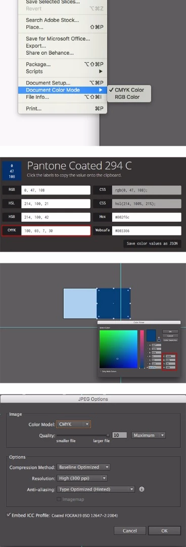

April 11, 2017
I was given an EPS file of company logo and was asked to export two JPEGs one for print and one for the web.
As far as I am aware CMYK colour mode is for print and RGB for the web.
Here is what I did when exported JPEG for print (see below). I did exactly the same thing in RGB mode when exporting for the web. Is this correct way of doing it?

April 11, 2017
Whomever asked you for a CMYK .jpeg for print was mistaken. You absolutely need to get the correct information from them, as this logo might be printing in 2 spot color stations rather than tints of CMYK.  2 spots would be seen as a higher color quality for a logo, than 4 process colors used to make 2 colors.
If they do not know what they need, ask them what they are using this for or the name of the printer. I try to guide people away from the antiquated .EPS format and Monika has written an excellent article on the topic.
