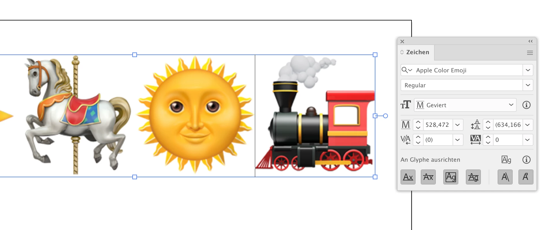

I need help, I have updated the operating system and the Apple Emoji Color font does not work well, the icon is cut at the bottom, does anyone know why?

Are you using Point type or Area type? Try using Point type. Is the font used Emojione?

FIXED!  On the setting s change from "Strong" to "Crisp" and it pops right up. wirked with FIre emoji havent tested with others. Going to assume it should work
Cowboy Ho
July 4, 2021
I am fixed this issue by upgraded both the MacOS and the Adobe illustrator.
Currently versions
MacOS: 11.4
Adobe illustrator: 25.3.1
May 12, 2021
I have the same issue in Illustrator 25.2.1
Has anyone found a solution to this yet?

Which system?

Hi there,
Sorry to hear about the trouble you are facing with Illustrator. Could you please explain the step by step process of importing these symbols into Illustrator (it would be great if you could share a small video)? Which OS and version of Illustrator is this? Was it working fine earlier? Is it working in other applications? If you are importing it from Glyphs panel, what is the name of the font?

What happens when you apply baseline shift in the Character panel? Or just type a return after that emoji?

Large enough?
Glad this is working for you Monika, but that doesn't help to solve the issue myself and others are having, per my image and on other forums.
