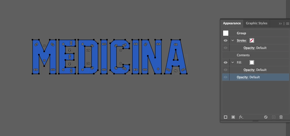

It depends on the objects in your file.
If you try to pick up a fill with a group selected, it appears to place the fill below the group contents. I don't know if it's always been this way or if this is a new error, since it does seem slightly odd.
Doug A Roberts
July 15, 2022

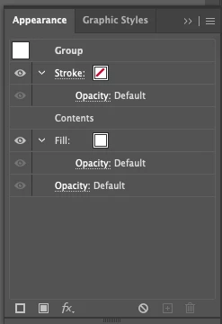

Open the appearance panel and check if there is another fill applied, possibly at a group level.
July 15, 2022
 Is another project, but the same error.
Doug A Roberts
July 15, 2022
The fill you are applying at the group level is below the contents. Either drag it above the group contents, or remove the fill from the constituent objects.
