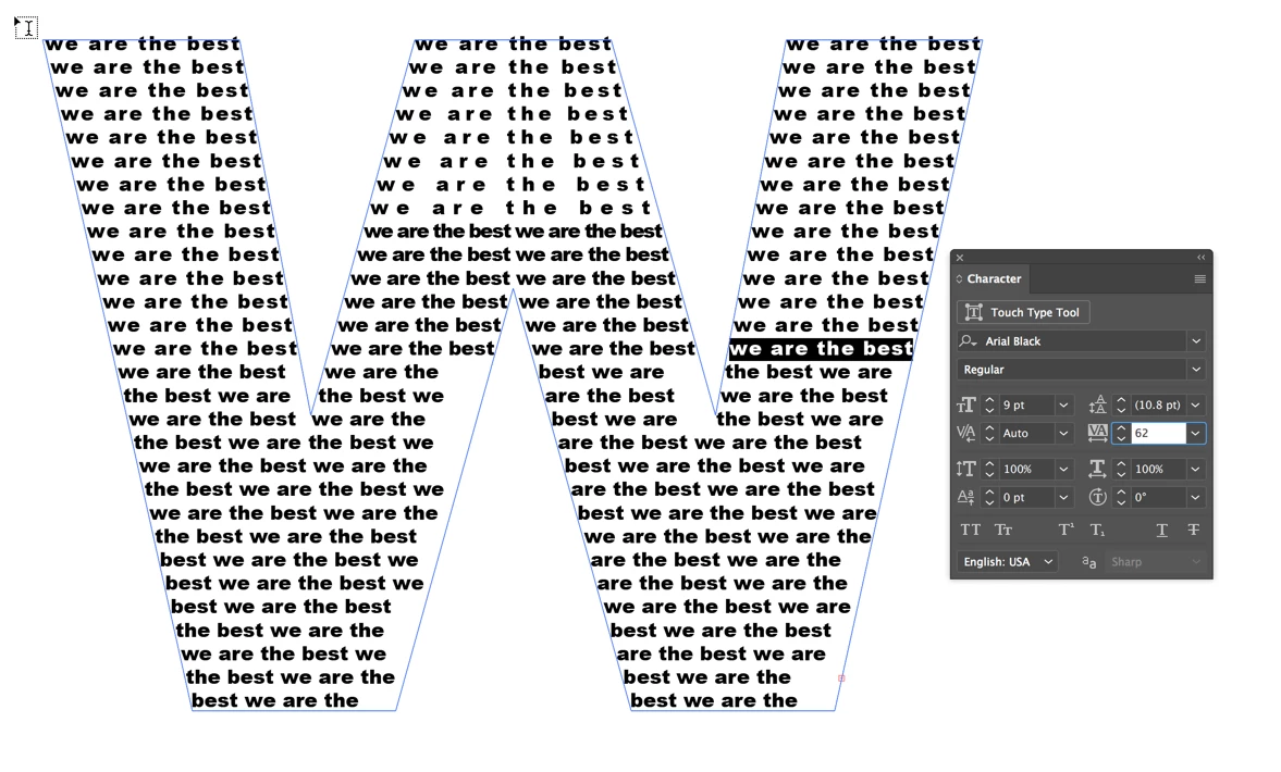

It's difficult to guess what kinds of problems you are having, so I offer this a merely one possibility for you to consider.

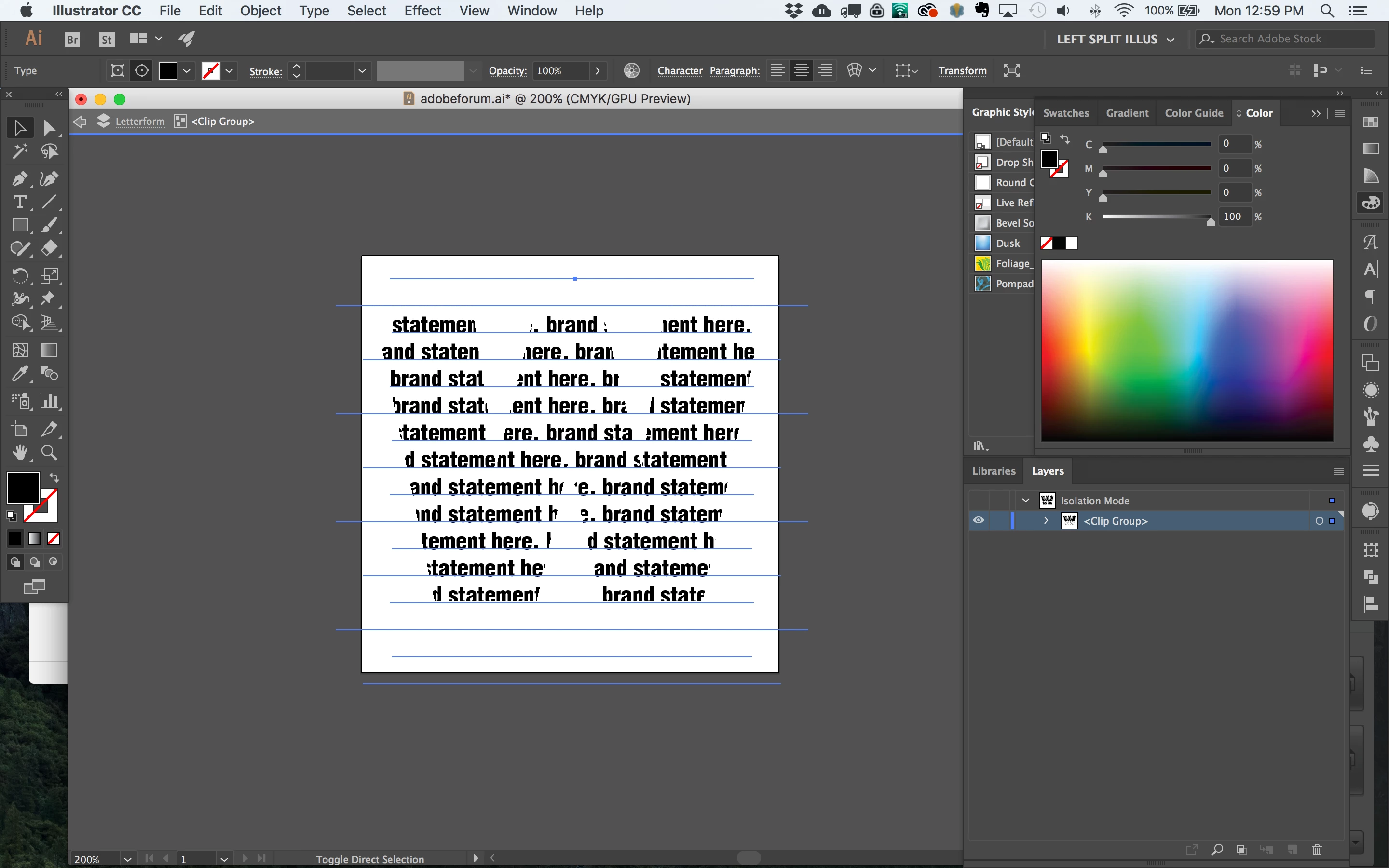

In this example I filled a type box with many repetitions of "we are the best", copied, clicked the outlined W with the Area Type Tool, and pasted. I decided on a type size that pleased me, then began to select each "we are the best", one at a time, and to adjust the tracking in the Character panel to make the phrase fit the space. Click in the Tracking number field to use the arrow keys to increase or decrease the spacing as needed. Obviously, I didn't finish the process. Yes, this is tedious and long, and I know of no way to do the whole thing in a click or two. There are several to try to make words fit: you can change type size, stretch words vertically or horizontally, change fonts, add strokes, offset path, etc., and my choices will be different from yours. I hope this will be of some use to you.

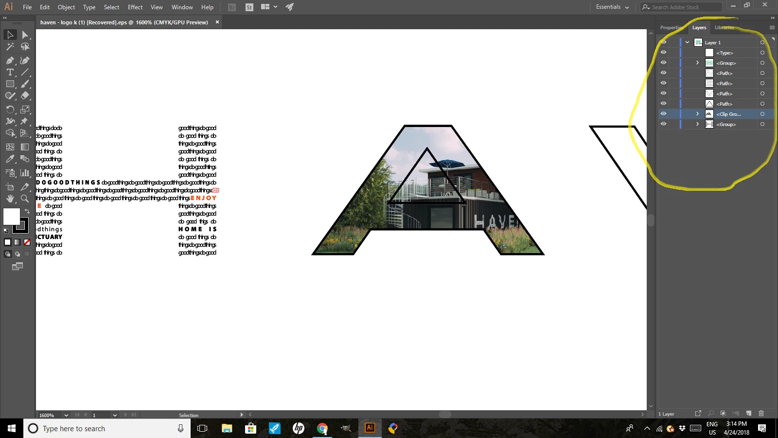

Does everything look okay in my layers panel? Before I start following new instructions I want to be sure my foundation is accurate...

Tiffany,
It looks as if you have the inner A path of the A separate on top and then a(n incomplete) Clipping Mask made from the outer A path and the image.
You need to first create the Compound Path from both A paths, then select that along with the image, as already mentioned by Larry, so you have to release the incomplete Clipping Mask, as mentioned by Monika.
Apart from that, it is always better to have the relevant artwork selected in order to get the full advantage of looking at the Layers palette.

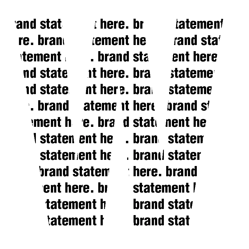

April 19, 2018

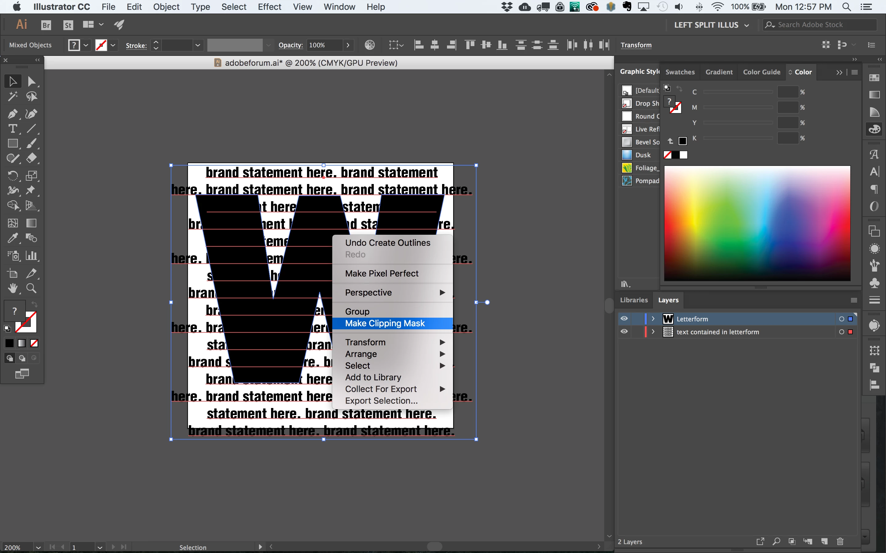

Would making a clipping mask be easier? Would it be alright if the letterforms are cut off along the larger letters' edges like the example here?
April 23, 2018
I'm happy to go this route, too, just to give my client a couple of options to choose from. If you have time to explain how you accomplished this, I'm certainly all ears (eyes in this case)
Thanks Jake!
creativejake
April 23, 2018

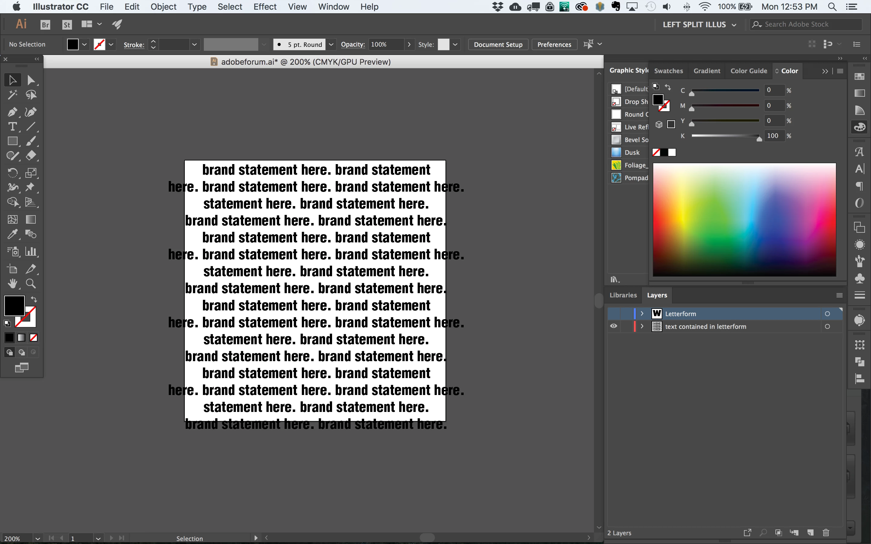

  1. Create the text that will be contained within the larger letterforms.
  2. Create the larger letterform and place it above the text.

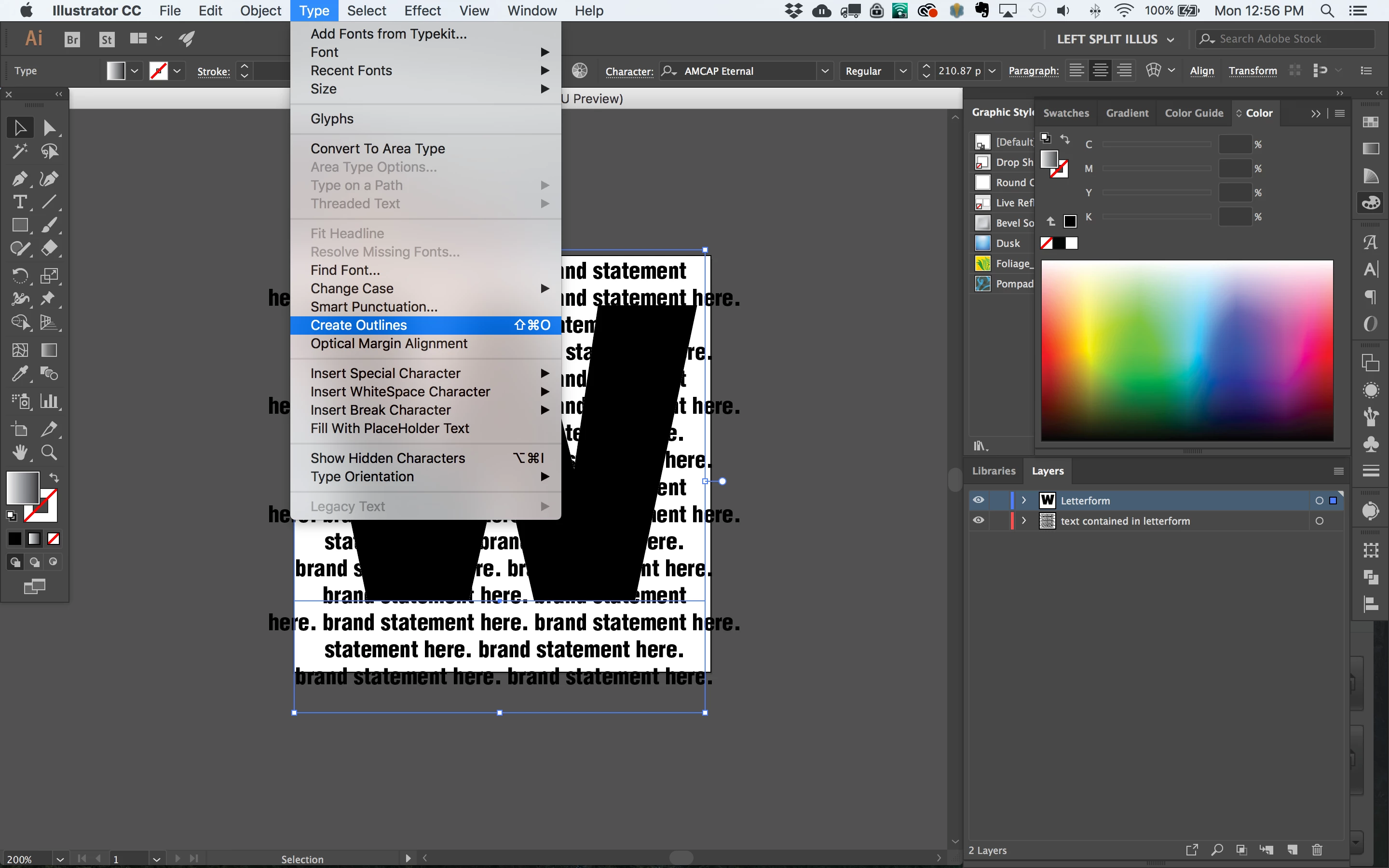

  3. With the larger letterform selected, Go to Type -> Create Outline  -- (this will convert the type into a letterform shape like you had done before)
  4. Select both the text and the now outlined letterform and right click to bring up the drop-down menu, then select "Make Clipping Mask"
    - this will make the letterform shape a clipping mask to the text that is behind it.
If you need to move or change the text inside the clipping mask, just double-click on the shape. You will see the "<Clip Group>" selected in the upper ribbon of the document window. Double-click away from the shape to go back to the regular artwork.
I use this technique all the time for a number of things. Hope this helps you.

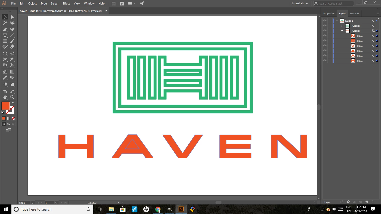

Something else for me to consider: would it be easier if I start from scratch and create a whole new " H A V E N " to work off of? The reason I've been avoiding that is because it is their branding and I'd have to duplicate it exactly....I don't know the font or how the original designer manipulated the sizing or anything so I wasn't sure it was possible to make happen... what would you all do?

I did what you said and I believe all letters have been released now. I attached a screenshot so you can see what I see over in the layers menu.
Does this mean I can likely follow the instructional video and the instructions you've outlined in this thread now without interference?
Is there anything I need to do once I complete the text within each letter in order to "unrelease" things again, or?

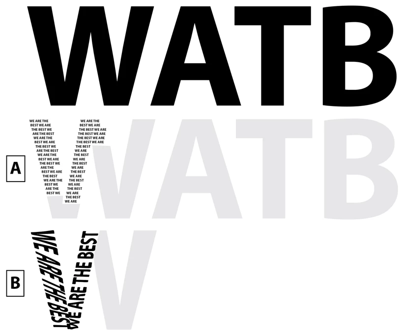

March 29, 2018
Not quite sure what you're after. Is one of these even close?
Peter
April 6, 2018
Hey everyone ~ Thanks so much for your replies. I was swamped with work and life and unable to respond so thanks for being patient.
Peter - option A is almost exactly what I'm hoping to accomplish. The only detail I would hope to adjust is to wrap the words inside the text in such a way as to mitigate all white space, so that things look very clean and edges are clearly defined. The effect that she accomplishes in this video tutorial is exactly what I'm hoping to accomplish: How to Fill a Character with Text in Adobe Illustrator - YouTube
However - when I followed the steps, it didn't work out for me... and I'm too new to Illustrator to troubleshoot just WHY that's so.
Looking forward to your replies and so grateful for your help.
Tiffany
