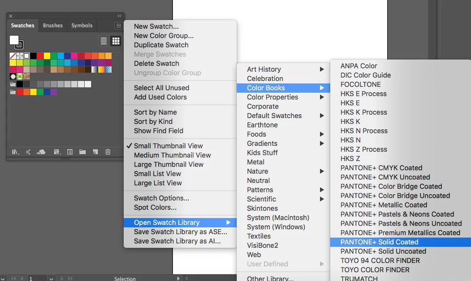

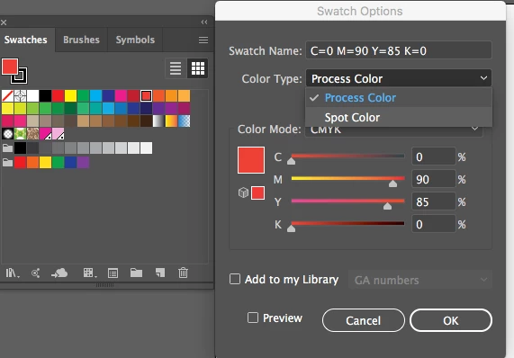

You prepare a vector file for printing with Pantone colors, either you choose the cantons before you start the illustrations, or you can change the process colors to Pantons later, I usually use swatch panel، check my screenshot, and I choose the best colors. when you click on the color it will be loaded on the swatches panel.
the colors with triangle with dot on the right, is the Pantone (spot color).
you can compare the color you have used with the Pantone color you choose.
also, you can double click on the CMYK (process color) to convert the process to spot. (the press will choose the exact Pantone that match your color.
Please ask for more information if you need, and how to change the gradient to Pantone.
Good luck.
